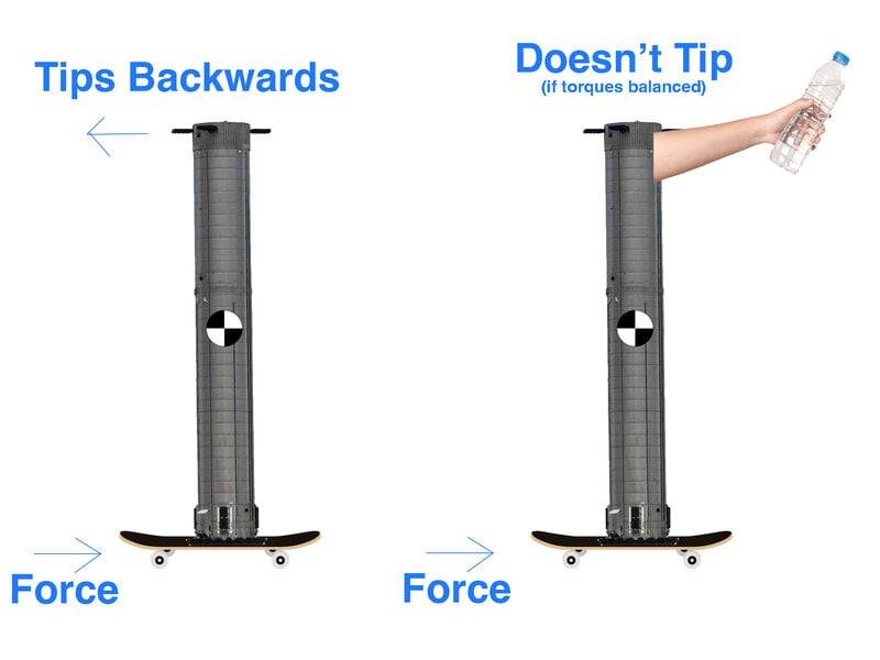

Imagine you are moving the starship booster and try to accelerate it too quickly from the bottom- it’s going to topple over backwards. By having a counterweight sticking out towards the front you could accelerate it faster without toppling. The weight hanging off the front causes it to want to tip over in the forward direction which counterbalances the tendency to tip over backwards if you try to accelerate it too quickly by pushing towards the bottom.
This is a far cry from the man on a skateboard or the man on a Segway that you've been speaking of. In both of those cases, there is a very active suspension in place.
If performance over a timed quarter mile is your goal for safe booster transport then one could equally well put hydraulic pads under the thing and tilt it forward at a crazy angle to get the same effect as a guy standing on top with a water bottle in his out-stretched hand.
If I were the engineer in charge, I would not be very receptive to ideas which involve attaching gear to the booster or in filling the craft with shiftable fluids. I would have to think long and hard before engineering a dynamic support system instead of a rigid attachment to the conveyor. Fewer failure modes to anticipate. However, tire pressure would be something important to look at. Those look like more or less ordinary pneumatic tires. Non-rigid. If you've ever built a tower from foam blocks, you may understand the stability problems that could result.
Using current booster transport setup, could we achieve greater acceleration without toppling by increasing the mass of the counterweights?
Sure. Not sure why they would want to, but sure.

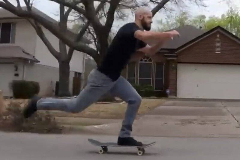

I was curious why I find myself naturally holding my water bottle forward while kicking on my skateboard (I would be carrying bottle in any case). That’s it. Im satisfied with the answers so far especially higher possible acceleration without toppling by increasing the mass of the counterweights on the starship booster transport system.
Devin-M said:
I was curious why I find myself naturally holding my water bottle forward while kicking on my skateboard (I would be carrying bottle in any case). That’s it. Im satisfied with the answers so far....
I dont think you got the right answer, because you started by providing your own wrong answer and pushed the discussion in that direction. The main reason you extending your arms is to counterbalance the weight of your extended leg when it is off the ground. It has nothing directly to do with acceleration/thrust and isnt at all related to the SpaceX crawler.
This is a bit of a red herring (i.e. while its technically true, it's not really applicable), here's why:
The booster is a rigid object. It can't deform to balance against acceleration. You can, and do.
The booster is an unstable object. It can't tilt to balance against acceleration. You can, and do.
So, what happens is: if you want to go faster, you simply crunch your body a little more or lean forward an extra couple of inches. The bottle does nothing but make that easier.
Here is the upshot:
You legs are the ultimate limiters on how fast you can go.
It's not that with the bottle you can go any faster - it's that with the bottle, you don't have to lean quite so far forward to achieve that same balance for your max acceleration. That's it.

Well he says in video you “throw your upper body forward so that way you can get as much from each push as possible.”
Yes. You can do this with your body.
Assuming you are a 70kg man, you mass about 200x more than a 355mL bottle of water. So, carrying the water, you are now a 70.355kg man. Anything you can do with a 70.355kg body, you can do with a 70.000kg body.
The bottle makes it a little easier to get that 1/200th of your combined mass two feet further forward. But don't be mistaken, you would accomplish the same thing without a bottle of water by simply leaning forward an imperceptible fraction of a degree more. And by imperceptible, I mean, you won't even know you're doing it.

He's not 'throwing' his upper body forward. He's leaning forward very slightly, bringing his body lower to the ground, and swinging his arms upwards and out to the front. Lowering your body lets your leg extend further backwards to push you, while bringing your arms up and forwards counteracts the down and backwards motion of your leg.
I remain convinced that your acceleration is limited by the physical ability of your legs than anything to do with balance.

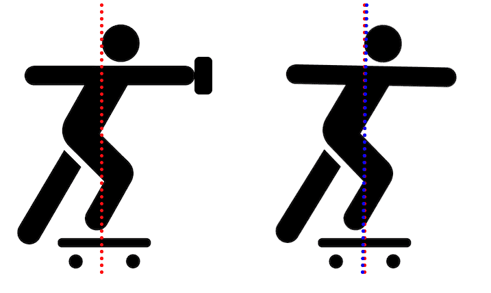

Drakkith said:
Keep in mind that the body is perfectly capable of balancing on its own without added weight. See this image:
Compared to this image the skateboarder has their knee bent as much as possible to prolong the push:
I know. I was illustrating that a person doesn't need extra weight to balance themselves with their leg fully extended.
