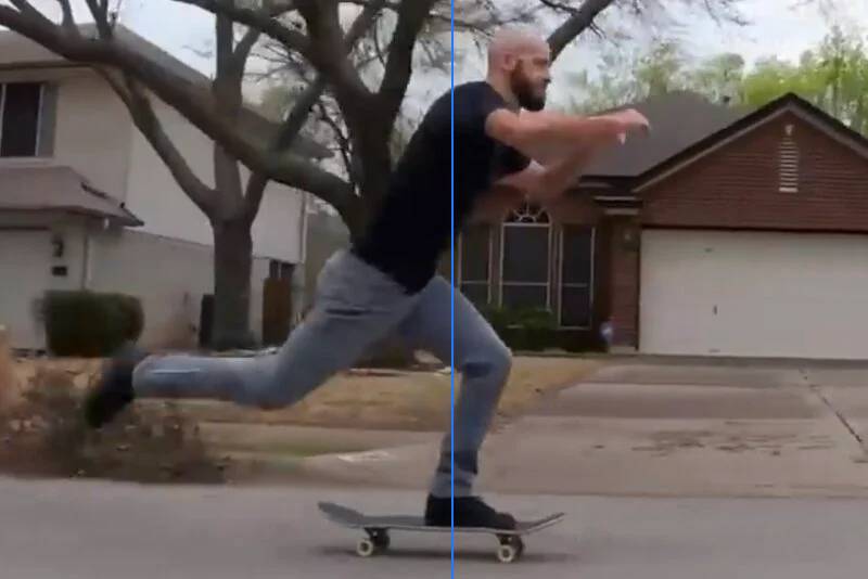

If we draw a vertical line through his ankle and look at how much mass is on each side of this line, to my eye he looks very close to tipping over backwards, and if his left knee were bent further he would seem even closer still to tipping backwards...
  • #66
I think you are still viewing the situation backwards: his weight has to be behind his plant foot otherwise when he kicks he'll fall forwards. [Edit] Or alternately, in order for his back foot to apply a force forwards, it has to be carrying some of his weight.
You wouldn't generally just bend your knee. You can see he's also bending at the ankle and hip. The net result of these motions may or may not move your COG fore/aft.
  • #67
*sigh*
We cannot tell from the picture where the center of pressure is on the shoe. The vertical blue line is just a guess. Also, it is a still picture. We cannot determine whether the posture is steady or if he is in the middle of a rotation. In particular, the state of motion of the right leg is unclear. He appears to be recovering from a kick.
If it were me, I might be extending the left leg forward a bit at the same time the right leg is kicking rearward. This would keep the net angular momentum of the body about its mass center to a minimum. In the recovery phase, the right leg would come forward and the left leg would come back, restoring a stable platform.
We know that the skater has at a number of means to regain balance even if he is currently on the verge of losing it.
1. He can extend the ankle, moving the center of pressure forward toward the toes or he can flex the ankls, moving the center of pressure rearward toward the heels.
2. He can extend the knee, moving the skateboard forward. Or he can flex the knee, moving the skateboard rearward. A similar effect can be achieved by extending or flexing at the hip or waist.
3. He can gyrate with his arms or right leg to temporarily maintain the body in an upright posture despite an unbalanced condition. This may provide time for (1) or (2) above to have an effect.
If he holds a water bottle forward, the same static balance could be achieved with a slight forward lean angle and no water bottle. If there is an advantage to be gained by holding a water bottle in the air, it is likely to do with (3) above and waving it around to help maintain stability in the torso.

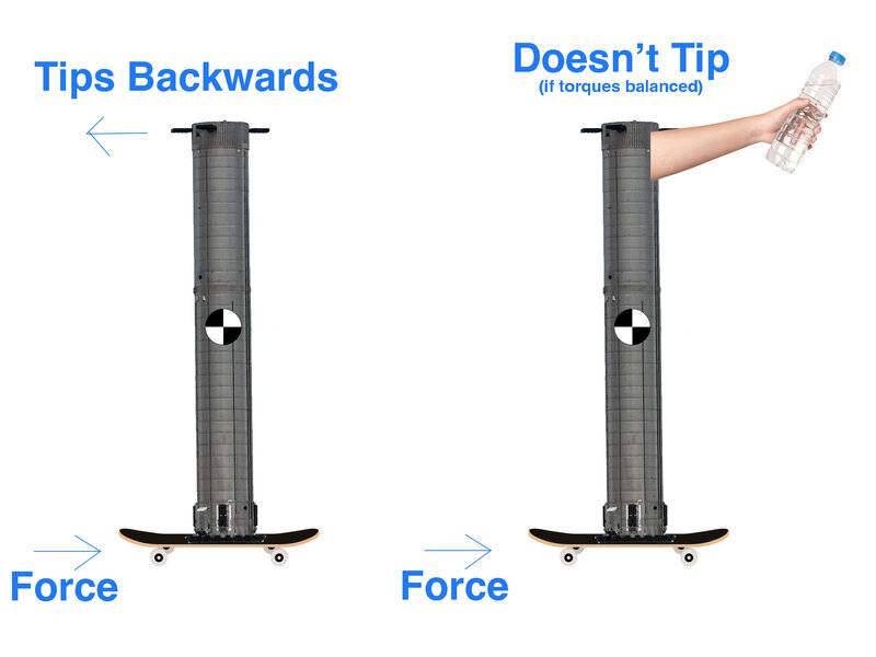

This sums up how I was thinking of it:
  • #69
Yes, I know that's what you think. Your force is pointing in the wrong direction (edit: and applied in the wrong place), so your conclusion is backwards. As I keep telling you.

Assume it’s an electric skateboard accelerating from left to right. With no bottle and enough acceleration, the top of the booster topples towards the left.
  • #72
Devin-M said:
How is the force in the wrong direction?
The force of ground on foot is upward and forward, not purely forward. It is hard to speculate precisely about its line of action -- which will move around during the kick anyway.
  • #73
Devin-M said:
Assume it’s an electric skateboard accelerating from left to right. With no bottle and enough acceleration, the top of the booster topples towards the left.View attachment 329658
This is better, but it is different from a skateboard propelled by the rider. You're still ignoring the force vector due to the weight of the rider though. The wheels apply a force up against that.

  • #78
Even on a normal skateboard the force propelling the rider is applied below the center of mass, still leading to a backwards toppling torque on the body.
  • #79
No!
