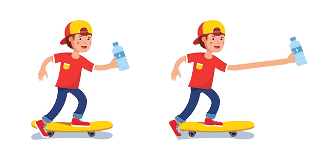

Sorry for the ridiculous title but this is actually a serious question.
Suppose we have a skateboard rider, right foot forward, left foot kicking. In one case the rider extends their arm directly forward holding a water bottle, in the other case they don’t. If the solution is limited not by the average output power of the kicks, but by the rider staying in balance, can the rider go faster holding the bottle and faster still if the bottle is heavier?
If the answer is yes, I suspect the bottle counterbalances the torque on the rider’s body induced by the ground kicks, so the heavier bottle enables more powerful ground kicks without the rider toppling.

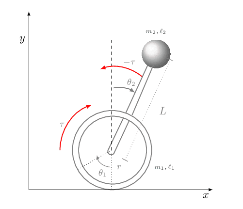

Consider an inverted pendulum fixed to a segway or one wheel board that has a robotic arm able to lift a water bottle forward. With the bottle lowered the pendulum is balanced and segway/one wheel board is stationary but with the bottle raised forward the pendulum is out of balance, leans forward and the segway / one wheel board begins to move in the direction the water bottle was lifted.

Would it take more torque from the wheel to counteract the torque of the leaning pendulum if the pendulum began telescoping so it was longer (weight concentrated at the end of pendulum)? Suppose the pendulum is already leaning as far forward as possible without touching the ground (or 90 degrees from vertical).
The height of the pendulum is irrelevant to the torque balance. Only the angle to the mass center matters.
Wouldn’t a longer pendulum act like a longer lever on the fulcrum at the hub, generating more torque?
A segway has a tilt sensor coupled to its motor electronically so that the speed is computer-controlled by the tilt. That has nothing to do with a human-powered skateboard.

:oops: Are you swinging the water bottle in a circle?
Do you accept that these skaters are both balanced and neither will go faster than the other?

I suspect the 2nd rider may have kicked harder to retain balance as the longer arm acts like a telescoping inverted pendulum.

Im curious why it seems to work for inverted pendulum on segway but not skateboard? Once the inverted pendulum is horizontal, and the wheel is outputting enough torque to keep it at that angle, the only way to go faster at constant speed seems to telescope the pendulum as that requires greater counter-torque from wheel to maintain angle.
Again: A segway has a tilt sensor coupled to its motor electronically so that the speed is computer-controlled by the tilt. It's programmed to do that. (If it did it naturally, it wouldn't need a computer to coordinate it.)
Yes, but the farther the inverted pendulum length extends (assume pendulum constant angle parallel to ground), the motor in the wheel needs to generate more torque to maintain the constant angle, leading to acceleration until the wind drag balances with increased torque at greater constant speed as the pendulum length increases.
