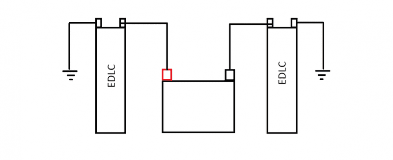

What about this situation? Should these supercaps charge? I don't have a second supercap of equal parameters; otherwise, I would try it out.

Edit: Yes, those caps would charge, I think. I connected it on Icircuit and it seemed to think so, though not really charged in a useful way. Your "ground" basically makes a short between both ends of the capacitors. If you just wanted to charge the cap, hook them both in parallel to the positive terminal, then the other end to ground, and the negative terminal of the battery to ground. That will charge them as long as the ground used is the same... Which means you're back to using a closed circuit in practice.
