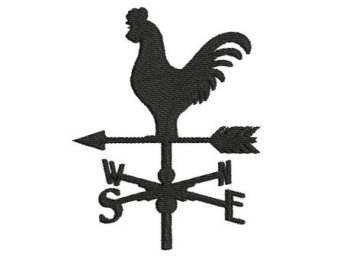

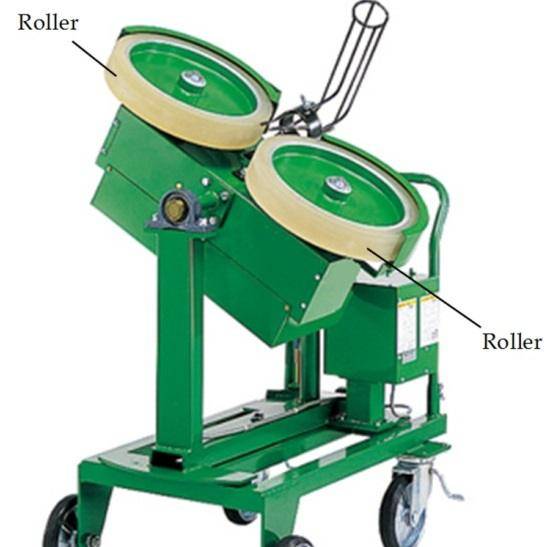

Not true. No mysteries here, just ordinary life. The ball throwing machine converts angular to linear. A bullet hitting the tail of the rooster converts linear to angular.
Do you happen to have any ball park figures on that experiment?
(But linear and angular momentum are both conserved in both cases.)
Energy can be transferred between linear KE a angular KE, because it is the same physical quantity.
Linear momentum and angular momentum are different quantities, that aren't converted into each other. Each is conserved on it's own.
[ATTACH=full]114789[/ATTACH]
[ATTACH=full]194353[/ATTACH]
Total linear and total angular momentum are conserved in both cases.
I stand corrected. Brain not working this morning.
