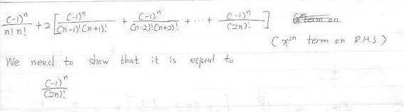

I manage to match the first two terms.
But when doing the n=k step in MI, I have no idea now to express it.
There are so many terms on the right contain x^(2k)
After some works, I discovered the coefficient of x^2n on RHS is like this (shown in the picture below).
But it seems it is impossible for them to be the same.
Ok. But that's not easy to read. Also, I'm not sure that's the best approach ok but it's essential in order to become good at math: to try things and if they don't work, well, you try something else so I admire you're willingness to at least try it and even if someone comes with a better way, you're on your way to becommng better at math. :)
