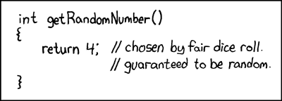

Without knowing how rand is implemented (and you don't), there is no way to answer this question. xkcd has a potential answer, though:
