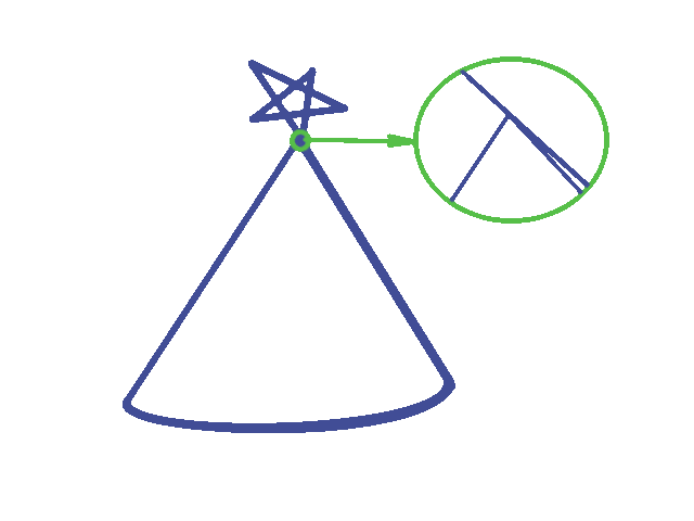

I have a marble on top of a perfectly conical hill. When it falls down the hill, how do I predict the direction it "chooses"?
Good model, I like it. In physics it's fine, and indeed it will be impossible to predict exactly how will be fall, but if we can add some abstract level we can easily determine. Let's say we have infinitely powerful zoom glass.,.
And indetermined becoming determined.

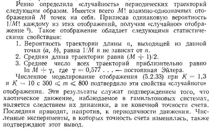

The point is there is a book which I understand almost nothing, the monography of some brain-like mathematicians, but it actually says that word "definitely" or "mathematically rigorously" should be used instead of apparently. There is two way to show it (and I don't even know if it mathematical prove or not), first way is crazy thing that called Solomonoff-Kolmogorov randomness, the second insane thing is called Rannou's mapping. I will put some screen shot of the book and the paper of Rannou F. 1974 year, which is somekind of a topological crazines which is shows that. The article is in public access on the suite of the journal so I have attached it to the post.
The screen shot with a topological "proof" —
Lichtenberg and Lieberman, "Regular and Chaotic Dymanics", 1992 year, pages 306-310.
I will try to translate, bu I have a poor knowledge of English:
"Rennou (she) has defined "the randomness" of periodical trajectories in the next way. It's have only ##M!## one-to-one mappings ##M## points on themselves. Writing the same probability ##\dfrac{1}{M!}## to any of that mappings, we obtain a "random" mapping. This mapping is have a next statistical properties:
  1. The probability of the trajectory with the length of ##n##, that exit from the given point ##(a, b)##, is equal ##\dfrac{1}{M}## and not depends on ##n##.
  2. The average length of the trajectory ##\dfrac{M + 1}{2}##.
  3. The average number of the all trajectories is approximately equal ##\ln{M} + \gamma##, where ##\gamma = 0,577\ldots## — the constant of Euler.
The numberly modelling of the mapping... has proved this properties of "randomly" mapping. This results is serve as the confirmation of that, the chaotic motion which is observed in hamilton's systems is a consequent of of their dynamics but not the result finitelity of calculus..."
How to understand it? :oldsurprised:
