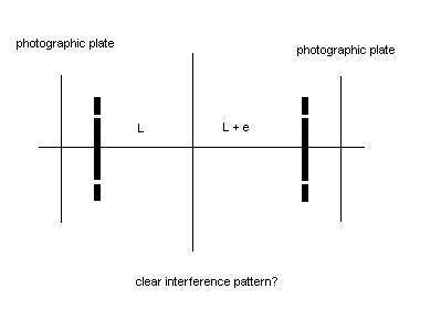

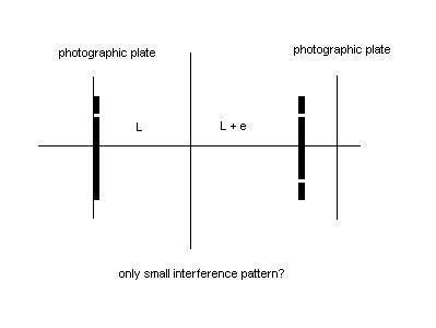

I am puzzled with the following gedankenexperiment.
Consider a pair of particles that are sent from x = 0 on different directions +x and -x with entangled position on the y axis.
Parallel to the y-axis we locate two double slit plates A and B. They plate A is located at x = -L and the plate B at x = +(L + e) ("e" is a very small distance). In the plate A one of the slits is closed. In the plate B both slits are open. The lower slit of the B plate is located at y = -h and the upper at y = +h.
When the particle 1 reaches x = -L its y-position will be measured, thus colapsing the whole 1+2 system and determining the y-position of particle 2. From this instant of time on, particle 2 will propagate with definite momentum spreading in y-position.
However, at that instant of time the particle 2 may be closer to one of the B-slits than to the other and there will be a greater probability that the particle 2 travels through one specific slit.
This will lead to a small interference pattern or to no interference pattern at all. Only in case that the y-position of particle 2 colapses at y = 0, the probability for superposition via both B-slits will be equal, leading to a clear interference.
However, if we open the second slit in plate A, the entanglement will not be destroyed (the y-position of the particle 1 will not be determined) and the y-position of particle 2 will remain uncertain. This should lead to a very noticeable interference pattern, more than in the first set-up.
At first sight this seams to be a way to have FTL comunication between A and B. Imagine that we send a series of particles one after the other and locate A and B at great distance. Observer A could set-up some kind of binary communication with B, opening the second slit in the A plate and allowing for interference between some hundred or thousand particles to be displayed at B. Afterwards, for the second set of hundred or thousand particles, A could close the second slit in the A plate and no interference (or practically no interference) would show up at B.
The problem in the usual EPR experiment with entangled spins is that the B observer has no way to know if collapse of the entangled system has taken place or not. His measurement looks always random for him and contains no information about whether A did measure or not. In this case, however, the double-slit experiment (interference or no interference) tells B if the collapse took place or not, knowing therefore if A did measure or not.
It is not clear to me whether it possible to have y-position entanglement to set up this experiment. if yes, will the results be as described? I assume it will not, but I cannot figure out the mistake.

Here I did my best to make some pictures. Consider A to the left and B to the right. The basic idea is that in the first case the y-position of the second particle should be determined in front of the B slits by measuring the y-position of the first particle at the A slit.

I understand this is your reasoning: in the first case, we know everything about the left particle, hence we effectively know which slit the right particle goes through, and there is no interference. In the second case, we do not know which slit the left particle goes through, thus do not know which slit the right particle goes through, therefore anticipate interference on the right. Yes?
You were thinking of FTL communication, that opening a slit on the left should "immediately" cause interference to appear on the right. FTL makes it easy to produce a paradox. Say the slit is open, and just after you've observed the interference, I'll alter the apparatus to insert a detector on the left (at x=-(L+2e)), to detect which slit the particle went through. If you prefer, then I can use some arrangement of mirrors and telescopes to make (or choose not to make) this "which path" measurement after you tell me whether the interference pattern appeared or not. (This is simply a convoluted form of Wheeler's delayed choice apparatus.)
The paradox is resolved if you never see an interference pattern on the right. This is to be expected because you can always, in principle, determine the "which path" information by measurements on the left. It's not enough to just not look at the measurement result on the left (which one might naively think is somehow different to not making the measurement at all), you would need to somehow quantum-mechanically "erase" the information (such that it cannot be reconstructed even in principle), and then (to preserve causality) you would have to somehow prove that you have done so (to the screen on the right) before seeing the interference pattern. This is exactly what occurs in the Delayed Choice Quantum Erasor experiment.
You have correctly interpreted the experiment. So you are telling me that even if the four slits are open there will be no interference in any of both sides. I cannot figure out this because in such a case the entangled system will be still in a superposition state. Interference should show up.
