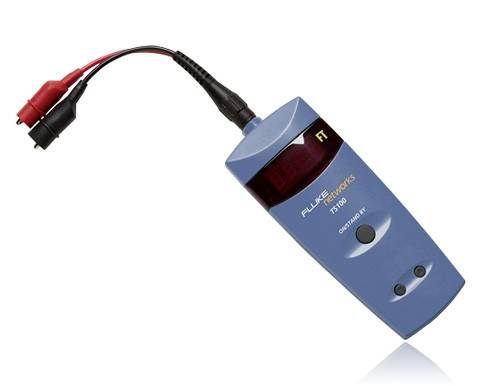

I'm thinking you need one of these:
http://www.flukenetworks.com/datacom-cabling/installation-tools/TS-100-Cable-Fault-Finder
You can make a home made TDR - with a single pulse and a half decent scope - calibrate on the good wires in the cable. I had been thinking of the cable tracers - but TDR is much better idea in a multi-conductor cable.
