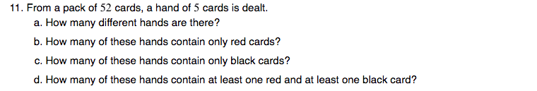

Can someone tell me where I'm going wrong here in part (d)?
Answers from textbook:
