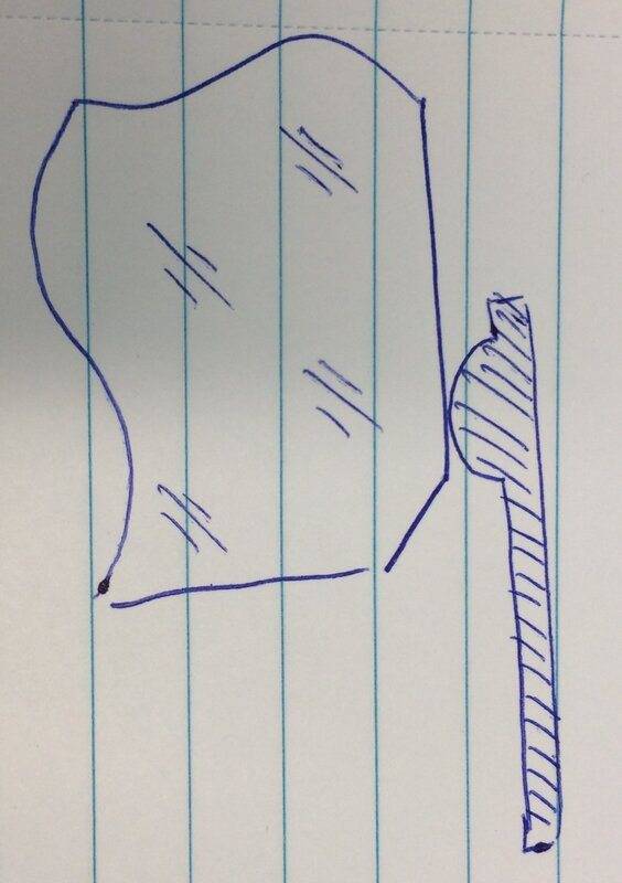

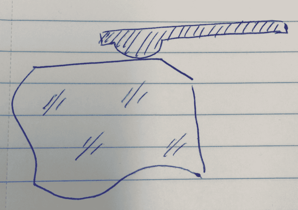

I need to design a spring clip (three identical clips will be used) that will retain a piece of glass in a mount, Figure 1.
Figure 1, spring clip shown retaining cut-away section of glass.
The clip needs to retain the glass with a set preload, F. The clip preload will induce a compressive stress in the glass, σg, and this should be minimised so as not not damage the glass. Figure 2 shows a diagram of the spring clip with its associated dimensions, ignore t and L for now.
Figure 2.

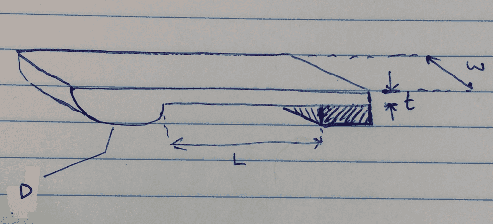

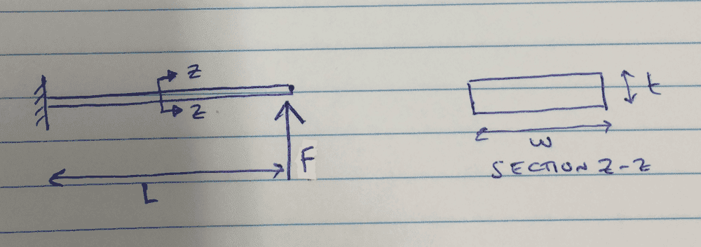

There's actually a second stress, that I left out on purpose, that needs to be minimised: σM, the stress induced in the clip itself, where the subscript M denotes metal. I left it out of the original post because I thought that I could apply whatever suggested method/corrections users posted in reply to σG, to that second stress.
To state the problem fully, I have a need to minimize both σG and σM. The stress in the clip is:
[tex]\sigma_M = \frac {My} {I}[/tex]
Where M is the internal moment induced in the spring clip (treated as a cantilevered prismatic beam, Figure 3), y is the distance from the cross-section neutral axis to the outmost fibre of the beam, and I is the cross-section moment of inertia.
Figure 3. Applied force, F, at free end. Section z-z shows the beam cross-section. Width is w, and thickness is t.
The stress can also be written as:
[tex]\sigma_M = \frac {(Fl)y} { \frac {1} {12}wt^3 }[/tex]
You can see now that w is a variable in both stresses. Basically I want something like the following:
[tex] \begin{align}<br /> \sigma_G = 0.798 \sqrt{\frac{\frac{1}{D} \frac{F} {w}} {K_2}}&\leq (0.2) \sigma_G,damage \\<br /> \sigma_M = \frac {(Fl)y} { \frac {1} {12}wt^3 }&\leq (SF) \sigma_M,yield <br /> \end{align}[/tex]
Where SF is some factor of safety.
I'd like to specify ranges for some of the parameters, for example: 10mm to 25mm for L etc.
My original approach was to set σG as 20% of the damage stress (as I've written above), set D at 50mm so it was easily machined and solve for w. Then I'd use that value of w to aid in finding the dimensions of the clip. It feels a bit, guessy, doing it this way.
Another thought is that optimization may be more applicable to determining σM than σG? D and w in the original post aren't really coupled with each other in the same way that the cross-section dimensions are coupled together to specify the moment of inertia in σM.
That stress will also be minimised by making the clip as big as possible.

In that case both stresses can be minimised by making the clips as large as possible within the limit. This can be seen intuitively and is also confirmed by the fact that the first derivative of the objective functions are always negative.
I've already decided to make the clips as big as I am able to. This was more of a parallel exercise to learn about the process of optimization, something I will likely be able to apply to other engineering tasks down the road. I thought that optimization may be a way to solve this as I wanted to constrain some of the geometric parameters of the clips to make machining and usage more practical. If you think that this is a bad example for a mathematical approach such as this, that is also a helpful answer.
