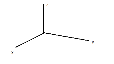

I don't understand your concern here. The usual convention for ##\mathbb R^3## has the axes labeled as in this drawing.
If you have two non-collinear vectors in ##\mathbb R^3##, their cross product will be a vector that is perpendicular to each. The convention for the right-hand rule gives you one vector; a left-hand rule gives you a vector pointing in the opposite direction, but with the same magnitude.
