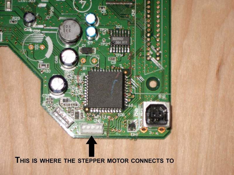

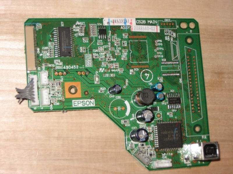

Hi,
I have a epson c88+ printer, I am trying to modify the Allegro A3977 Microstepping Driver, to move the incoming signal for the stepper motor and send it to 2 additional stepper motor drivers, so that I can run 2 stepper motors off that same signal.
I have little experience in this field and I would greatly appreciate your kind help and support in guiding me true this project.
Thanks in advance!
  • Green printed circuit board labelled EPSON, marked C528 MAIN ASSY, with a USB port at the lower right and a ribbon connector at the left edge.

  • Close-up of a green printer control board with a black square microcontroller chip, electrolytic capacitors, and a white connector labelled 'White' and marked with an arrow reading 'This is where the stepper motor connects to'.

Welcome to PF.
From the pic it looks like 4 wires going to the stepper.
Is one pin connected to the ground plane/Vcc or do all 4 go to the IC.
You probably need an oscilloscope to check the pin relations when operating or you might get the same info from the stepper motor specs if you have that.
In the first case you can probably use three transistors as switches.
in the later you will probably need to use two pins to drive H-bridges.

Ok, That's fairly complicated.
I suspect the simplest solution would be to get a couple more of these chips, replicate the chip local support circuitry, and fan out the original control lines to the new chips.
The other option looks to be designing a unity gain h-bridge current amplifier as this does not look like simple on/off step switching. Page 41 of the motor datasheet probably has more info on this, but you didn't include that page.
Good luck.
