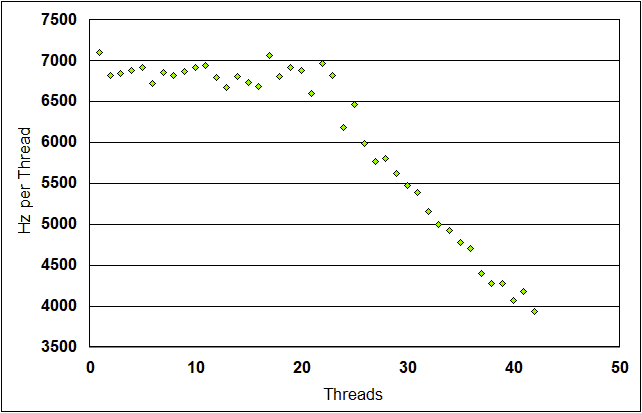

So, I managed to rework the parallelization and got it down to under an hour. Barely. I can find all 275M squares in 59 minutes and 23 seconds. This uses 32 threads on a 12C/24T processor. It's 22.9x faster than one processor.
About ten minutes towards the end, threads start terminating. So there is some room to improve the load balancing: perhaps 5%. This is mitigated somewhat by the fact that as threads terminate, the chip speeds up.
Another potential source for a 5% gain is squares with 13 as their center. If I find a square with 12 as its center, I have also found one with a 14 as its center, under the {26-x} transformation. If I do with with a square with center 13, I find a different square with center 13. So effectively I find each pair twice. If I could find a way to quickly reject the "second" member of the pair, it would double the speed of the 13's, saving maybe 5% overall in time.
That same symmetry has interesting implications for early detection of patterns with no solution. There's been speculation that looking at subsets of cells (one or two diagonals) mod 5 one can conclude there are no solutions. Because of the {26-x} symmetry, should such a pattern be found, a second pattern could be found swapping 0 and 1, and 2 and 4. I think that's very interesting as it is not the "normal" 1 and 4/2 and 3.
I'm not sure if this is a breakthrough or proves it impossible.
Here are the scaling plots (for center = 1 and 25):
