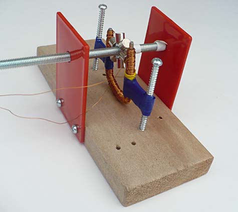

It depends on the object of your project. One way to go would've to use a hand made generator with permanent magnets. It might not make enough power to light a LED, but it would have the advantage of being entirely open and obvious to people looking that it. The waterwheel and such a generator show the principle of making electricity from rain power in such a way that there is no mystery about how it works.
