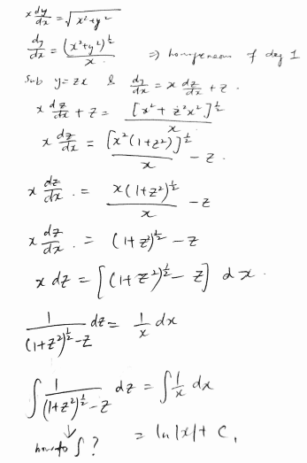

Hi, I have solved this ODE till half way and got stucked on the integration of some weird expression. Need help for this.
Thank you!

Hi Alexis87,
Rationalizing the denominator should help.
