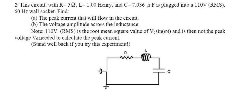

Hi here is the problem:
What I did was Z=[(XL-Xc)2+R2]1/2 = 5 ohm
and then V/R = I = 110(2)1/2/5=31.1A
For part B) I did V=L(di/dt)=-Lwsin(wt), and the peak amplitude is when sin(wt)=-1 and is 377V.
Can someone tell me if what I did is right, or what is wrong?
Thanks.
mmmboh said:
What I did was Z=[(XL-Xc)2-R2]1/2 = 5 ohm
For part B) I did V=L(di/dt)=-LWsin(wt), and the peak amplitude is when sin(wt)=-1 and is 377V.
Your impedance formula is incorrect. Also, what value did you use for ω?
Sorry I meant +R not -R..but I used the right formula when calculating the value of 5. For w I used 2(pi)f=377 Hz
Looks OK then. I assume that you plugged in the numbers and got XC and XL correctly.
I did (wL-1/(wC)^2 for XL-Xc
That's fine. I hope you plugged in correctly.
