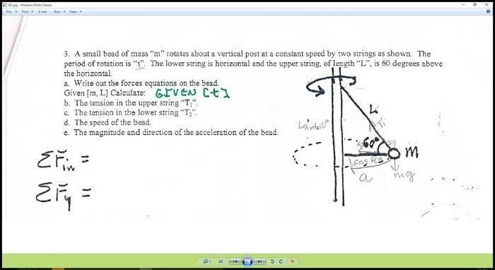

Can someone check if this centripetal force is correct?

I don't know if my ΣFin is correct I am having trouble setting it up. Can you check if the new diagram and the component setup is right?
Problem:
Handwritten physics problem sheet: a bead of mass m on two strings rotating about a vertical post, with the upper string at 60 degrees above horizontal and a horizontal lower string of length L, plus force-sum equation placeholders.
Work:

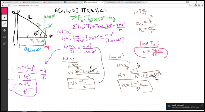

Handwritten physics working on a whiteboard: a conical pendulum diagram with string length L, angle 30 degrees, tension T1 and T2, mass m, and the sum of forces equations, followed by derivations for velocity v and acceleration a.

Work:
Handwritten physics work on a whiteboard: a conical pendulum diagram with angles 30 and 60 degrees, equations for tension T2 and centripetal acceleration a = 2π²L/t², and a boxed final expression for T2.
looks very good except at the very end you made a couple of math errors when solving for T2( forgot to subtract out the mg/root 3 term and the 1/2 factor in the denominator was overlooked. ).

Oh wow, nice catch. Thanks!
