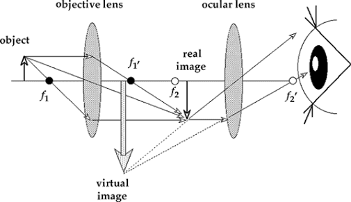

I have a very basic doubt in optics . The picture below is used only to make question clearer .
Suppose ocular lens was not present and position of the eye remains same , then will the person see the real image formed by the objective lens ?
Thanks

Yes. It may be too close to his/her eyes to see it sharp, but: yes.
You can experiment with one simple lens (*).
Not clear to me why you consider this a doubt in optics, though.
(*) with an old (photographic film) SLR camera it's insightful: open the camera; you know where the real image is (in the plane where the film should be) and you can examine it with and without an ocular lens.

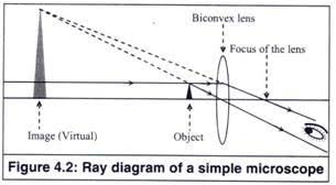

Suppose the person was to the left of the biconvex lens , then will he be able to see the virtual image formed by biconvex lens ??

No. The dashed lines are just a continuation of the solid (and real) rays to the right of the lens. The dashed lines represent virtual rays.

Sorry . I know this is very basic stuff . But I am not getting how does a person see the image of an object ??
Could you please explain why the person sees the real image in first condition but not the virtual image in the second condition .
To the left of the ocular in the first condition, the image formed by the objective lens is real, i.e. actually present. If you place a screen there, the image is formed on the screen.
To the left of the biconvex lens in the second situation, the virtual image is not really there: a screen would not have an image formed on it.
In the same way as there is nothing behind a mirror: we use dashed lines to find the position of the virtual image.

Human eye can see both real and virtual images .Right ?
Then why can't the person see the virtual image in second case ?
Is it because the refracted rays directly enter the eyes in first case but do not directly enter in the second case ??
The location of an image as seen with our eyes, depends on the directions of the light rays as they enter the eyes.
If you place your eyes to the right of the lens, and look towards the left, the directions of the rays that enter the eyes are such that they extrapolate back to the image location.
If you place your eyes immediately to the left of the lens, and look towards the left, the directions of the rays that enter the eyes are such that they extrapolate back to the object location.
Yes. They can't see virtual rays (the dashed lines) because they are not there. A virtual image can be seen if the virtual rays become real rays before they reach the eye. Virtual rays are just auxiliary lines we draw to find their intersection points: the points where they seem to come from, but never passed.

In the second picture , what happens if we place the eyes to the left of object and look towards left ?? Why don't the eyes see the image ?
In that case, do any light rays at all from the object enter the eye, whether directly from the object, or after refraction through the lens?
No .
But if it looks toward right , the light from the object enters the eye . So it sees the object .
Don't the refracted rays ,when extended backwards , enter the eyes ??
Those (dotted) rays do not exist. They are only construction lines to show the virtual position from where the rays appear to originate. You appreciate that there no light coming from the lens from right to left??

So , the eye sees the image , whether real or virtual , when actual refracted light rays enter the eyes ??
Vibhor said:
Ok.
Of course. The retina needs Energy to make it work!

Back to the first case in the OP i.e oculur lens not present .
Eye sees the real image formed by the objective lens because the refracted rays from the objective meets/converges at the point where real image is formed and thereafter the same rays diverges and enter the eyes .
This is similar to as if a real object is present at the point where the real image is formed , and , real light rays emanate from the object and enters the eyes . This is how eye sees the real image of the object .
Makes sense ?
Sort of yes. Only remember that real (and virtual) images do not produce "new rays". You can see only rays that originated in object.
Is this correct ??
Yes. That's correct.

Yes. I can look down into the eyepiece barrel of my telescope without an eyepiece in place and see an image of the scene in front of my telescope. The view may not look very good compared to the view with the eyepiece in place, but I can still see something.
An interesting exercise may be to take a simple magnifier (magnifying glass), mount it a set distance from an object such that the distance is larger than the focal length of the lens, and then move your eye closer to or further away from the magnifier and seeing how the view changes. This setup will ensure the image's magnification and distance from the lens remains constant so you can focus on understanding what happens when viewing a real image.
You can then move the magnifier closer to the object such that the object is now inside the focal point of the lens. Now the viewed image is virtual.
