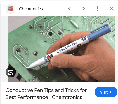

For any practical less theoretical purpose I would rather recommend those 'conductive pen' things.
For those, it's not entirely hopeless to connect actual components easily.

That is a good question, and shows that you are thinking as you learn more about electronics.
Can you list some of the practical problems with such a pencil/paper circuit? What kind of things limit the usefulness of such an implementation (some of them have already been listed, but there are more and you can provide more detail)?
And which of those problems are partially solved by using the conductive ink approach to making a circuit? Which issues are still problems?
And finally, how do traditional PCBAs overcome those difficulties? It's good to think your original idea all the way through this process, so that it starts to become a habit in the future when you have more creative ideas and questions. :smile:
A hand holding a white Chemtronics conductive pen with blue accents, drawing on a green printed circuit board with silver-coated traces and solder pads.
https://www.chemtronics.com/conductive-pen-tips-and-tricks-for-best-performance

I love the conductive pen idea and I never knew it existed. I think a limitation to the paper and pencil circuit is that it can't handle high voltage so it will catch on fire if any high voltage is applied on it. It would be pretty fun to make very small yet working PCB projects using that method. Thanks for the link I will check it out.
