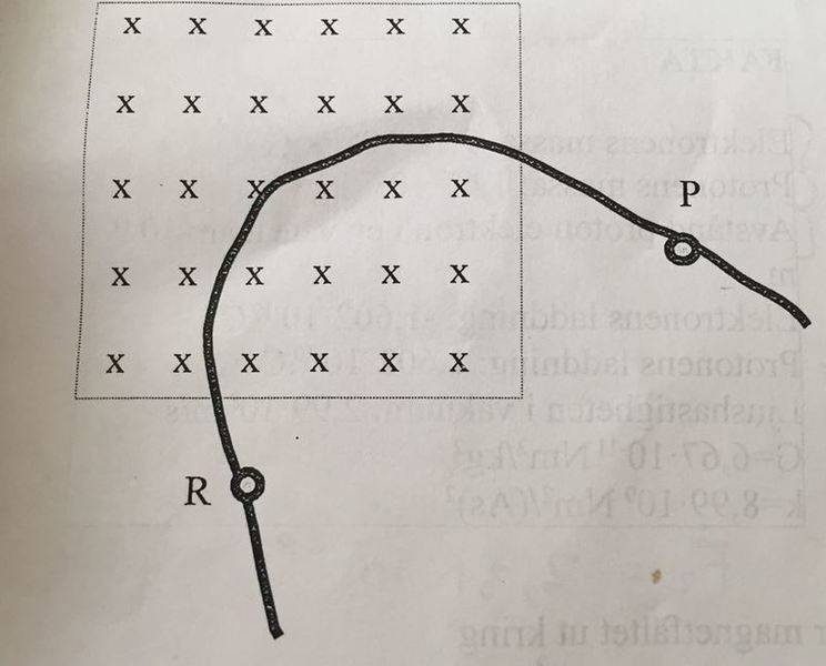

A electron passes through a vertical magnetic field like the figure shows. The path is in a horisontal plane.
a, Give the motion direction in the path.
b, The electrons velocity is constant under the whole passage through the field, explain this!
No equations
My exp;
a, The force will point to the "middle" of the circular motion that occurs. The force is perpendicular to the motion, and the electrons motion is directed to the currents.
b, F is perpendicular to the motion, the velocity remains therefore constant because the electrons kinetic energy does not change.

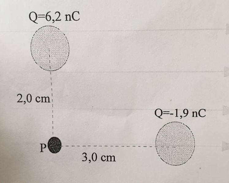

ASSIGNMENT 4
Look at the figure, which force acts on a positive charged proton in the point P?
Equations:
F=k*(q1*q2)/r^2
Fres=F1+F2
Solution tried
F1=8,99*10^9*(1,602*10^-14)*(1,9*10^-9)/(0,03)^2
F2=8,99*10^9*(1,602*10^-14)*(6,2*10^-9)/(0,02)^2
Fres=? Iam not sure how to keep on going here...ASSIGNMENT 5
