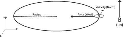

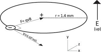

But I digress; in the meantime, is this close for the diagram or am I way off? Should (up) point to the top of circle or off of the x,z plane? Should I even include a 3rd dimension... So much confusion. I think I have this wrong in the image for sure... I've been looking through pics and I've been trying to absorb stuff from hyper physics and alike. I'm not sure if it's supposed to have all the magnetic field lines or not or maybe lines to show the force...
Another thing that makes me think is how do you state the direction, if it's centripetal force, I think of it revolving around an axial point, but the question is vague I don't know... If that is right, do you state something like 90° perpendicular to the velocity? I'm probably way off.

Re direction of the force: You've got it quite correctly (apart from typo like E (up) instead of B). The + in the center of the circle marks the center I assume (and not some positive charge...). And the exercise mentions N, so you want to make clear that F points West initially.
Vector product: turn v towards B over the smallest angle. The direction where the corkscrew goes is the direction of ##\vec v \times \vec B##. To the left in your picture. The sign of q (electron) makes it point the other way -- as you drew it.
If you prefer handedness or don't like corkscrews: thumb is v index finger is B middle finger bent points in the direction of ##\vec v \times \vec B##.
x,y,z is somewhat vague -- and you draw a left-handed coordinate system. My advice (see above): never ever before your PhD unless forced. Stck to right-handed !The exercise doesn't give a size for the 'region', so you can't tell if the electron comes out again or keeps circling. I'd draw a circle too, assuming the region extends over more than 3 mm.

About the right hand rule, I think I see what you mean but still may have some work to do? Is this better?
Is it okay to have north in South's negative? Normally I imagine South is the negative of North. Or should I flip the circle's N and S?
And with F = qvB = mv2 / r ... Why is r = mv / q/B better than r = mv2 / F
One thing I need to understand is why the initial force is west?
How does an initial magnetic field directed up, an initial velocity directed north equal an initial force directed West?
Picture was good already. Now it's near perfect.
N and S: just fine.
B is up: given.
Force is West: ##\
\vec F = q\;(\vec E + \vec v \times \vec B)\ =\
q\; \vec v \times \vec B##
Vector product: turn v towards B over the smallest angle. The direction where the corkscrew goes is the direction of ## \ \vec v \times \vec B## . To the east. The sign of q (electron) makes it point the other way -- as you drew it.
