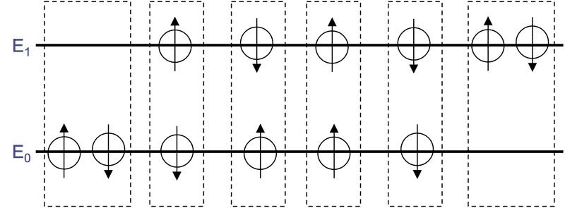

Consider two identical particles that follow Fermi-Dirac statistics in a thermodynamical system with two energy levels, ##E_0## and ##E_1##, ##E_1 > E_0##, that do no interact and are in contact with a heat reservoir at temperature ##T##. Determine the canonical partition function.
##Z = \sum_\text{all configurations} e^{-\beta E}##
My solution is
Z = e^{-2\beta E_0} + 4 e^{-\beta (E_0 + E_1)} + e^{-2\beta E_1},
since Fermions have non-zero spin and there are four options for distributing spins (assuming only ##\pm \frac{1}{2}##) among ##E_0## and ##E_1## such that ##E_\text{tot} = E_0 + E_1## and one option each that leads to a total energy of ##2E_{0,1}##. However, I'm not sure whether or not the terms ##e^{-2\beta E_{0,1}}## should also be weighted with a degeneracy factor (##2## in this case), because both up / down and down / up are possible. The quantum state remains identical under swapping the spins, but it also leads to an additional option to obtain the same total energy.
Help is appreciated, have a great day everyone.
Just list the possible total energies and the particle configurations for each. You have
##(E_0,E_0)\rightarrow 2E_0##
##(E_1,E_0)\rightarrow E_0+E_1##
##(E_0,E_1)\rightarrow E_0+E_1##
##(E_1,E_1)\rightarrow 2E_1##
The degeneracy for the middle energy is 2 not 4.

TSny said:
There are four two-particle states with total energy ##E_0+E_1.##
How do you count 4? This is how I count 2.
We are told that two particles are at thermal equilibrium with a reservoir and that each has two energy states characterized by ##E_0## and ##E_1.## To me this means that they can absorb thermal energy ##E_1-E_0## from the reservoir and transit from ##E_0## to ##E_1## or that they can deposit thermal energy ##E_1-E_0## into the reservoir and transit from ##E_1## to ##E_0.##
We are also told that they are non-interacting. To me this means that each particle does its own thing independently of the other. Now I count microstates of the two-particle ensemble (it's like tossing two coins and looking at the possibilities of heads and tails) and I get the results posted in #2:
There are two energy levels, but we are not given any information about the number of single-particle states with energy ##E_0## and the number of states with energy ##E_1##. If there is only one single-particle quantum state available for each energy level, we cannot put two particles into the same energy level. That would violate the Pauli exclusion principle for Fermi-Dirac statistics. So, ##(E_0, E_0)## and ##(E_1, E_1)## would not be allowed.
Consider the one-dimensional particle in a box with ground-state energy ##E_0## and first excited-state energy ##E_1##. Ignore all higher energy levels. For a single spin 1/2 particle in the box, there are two states available for ##E_0##. One state has "spin up" and the other "spin down". So, ##E_0## is doubly degenerate. Likewise for ##E_1##.
If we put two identical, noninteracting, spin-1/2 particles in the box, there is one allowed two-particle state where both particles have energy ##E_0##. In this state, the two spins are opposite and form a spin singlet. Likewise, there is one two-particle singlet state where both particles have energy ##E_1##.
There are four two-particle states with one particle in the ground state and one in the excited state. One of these states is a spin singlet. The other three states correspond to a spin triplet.

That said, I confess that I interpreted rather loosely the "not interacting" part and disregarded the statement that the particles "follow Fermi-Dirac statistics." To redeem myself, I post a schematic of the six microstates below for indistinguishable fermions. The number of microstates having energy ##E_0+E_1## is indeed 4. My apologies for the confusion.
kuruman said:
I know what you are trying to say but it does not come out right. ##(E_0,E_0)## is allowed if one particle is spin-up and the other spin down. It is not allowed if both are spin up (or down).
Agreed. For a spin 1/2 particle, there is a state with energy ##E_0## having spin up and another state with energy ##E_0## having spin down. So, there are two states of the particle with energy ##E_0## and, likewise, two states of the particle with energy ##E_1##. So, we can have ##(E_0, E_0)## or ##(E_1, E_1)## without violating the exclusion principle.
