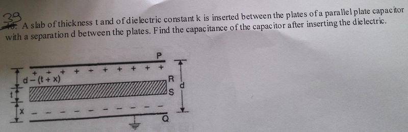

Hi. My instructor gave me this problem as a homework. Actually he didnt teach us this subject. So what should i know to solve this question or from where can i study to this subject? Of course it would be great if someone solve the problem but i don't want to take your time, just need the info of this subject to learn the subject and solve the problem. Thanks..
kuruman said:
Check this out. Then come back if you have questions. Note that the dielectric does not fill the space between plates completely. This needs to be taken into account.

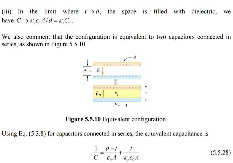

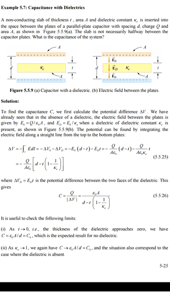

Thanks for the answer. After i learned the subject, i solved the problem. Then i noticed my answer is the same with answer on the pdf. (check image) I think it is the same question by the way. Isn't it?

Yes, it is the same. Note that the exact position of the dielectric does not affect the result as long as the dielectric surfaces are parallel to the plates.

Im not sure i understood you. so does it change the result at my problem? Or you just said me that as an info? Sorry for my eng. Thanks btw you helped me a lot.
Just a point of information in case you see this again. The answer does not change,
