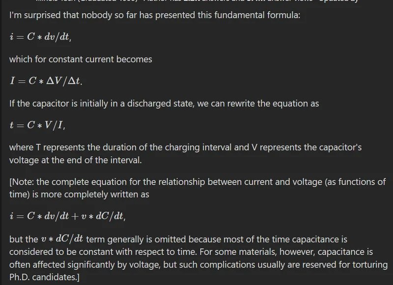

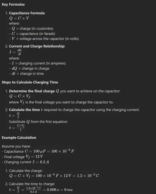

While attempting to calculate capacitor charging time I came across two conflicting concepts. I think my confusion can be pretty much summed up by the top two responses to this quora post:
https://www.quora.com/How-can-I-cal...-the-charging-current-voltage-and-capacitance
Pasted below for convenience.
I understand the first guy's response results in a time value that is half of the answer provided by the assistant bot. That comes from the energy loss of charging the capacitor being a factor of 2(we lose half our power to heat and other losses when charging a cap). But I am having trouble coming up with the why/how through the use of a proof. There is something that he is missing when integrating the current with respect to time but I cannot figure out what.
Answer 1:
Answer 2:

Given constant i and constant C.
C = Q / V ; definition of capacitance.
Q = i ⋅ t ; charge.
C = i ⋅ t / V ; ∴ t = C ⋅ V / i .
V / t = i / C ; ∴ dv/dt = i / C .

The answers are the same. both give t = C*V/I. I don't understand what the problem is
