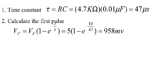

I would like to understand how the Euler constant elevated to fractional exponent gave this result? 958mV someone please!?
You did not give enough information for us to check everything, but the calculation is correct (I checked it on my old HP calculator).
It is because my doubt is the fractional exponent, do not know why has this result!

Charging of a capacitor is an exponential
event. Voltage across capacitor rises exponentially as
Vc=Vf(1-e-t/T). Time t is in the exponent, hence the part e-t/T is responsible for the exponential increase in voltage w.r.t time.

OK. Let us take it in steps:
  1. \frac{10}{47}= 0.212765957
  2. e^{-0.212765957}=0.808345302
  3. 1- 0.808345302=0.191655
  4. 5 \cdot 0.191655 = 0.958273

Yes! , I understand, but using numbers,
