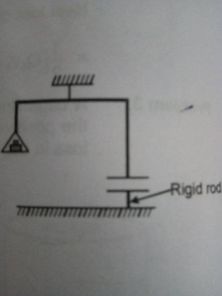

The lower plate of a parallel plate capacitor is supported on a rigid rod.The upper plate is suspended from one end of a balance.The two plates are joined together by a thin wire and subsequently disconnected.The balance is then counterpoised.Now a voltage V= 5000V is applied between the plates.The distance between the plates is d=5mm and the area of each plate is A=100sq.cm. Then find out additional mass placed to maintain balance.All the elements other than plates are massless and non conducting.
  • Diagram of a parallel plate capacitor hung from a beam balance: the upper plate hangs from the left arm, the lower plate sits on a rigid rod standing on a hatched surface, with a pan on the left arm.

I don't see an attempt at a solution. Hint - try using the principle of virtual work.
I had done Q^2d/2A ×apsilonnot =mg
