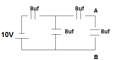

Q) In the adjacent circuit, find the potential difference across AB

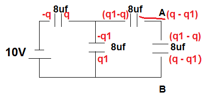

Fine , now i did the charge distribution as follows
Now in the first loop (sorry i forgot to mention the points in my image)
applying kirchhoffs loop law
10 = q1/8 + q/8
or, q + q1 = 80
Next in the second loop
q1/8 + (q - q1)/8 + (q - q1)/8 = 0
or, 2q - q1 = 0
or, q1 = 2q
gives, q = 80/3 uc
Again in the second loop
VA - (q - q1)/8 - q1/8 = VB
=> VA - VB = q/8 = 10/3 V
but answer says its 2V.
Definitely i m wrong but where?
Any help is appreciated..!
I'm not sure I follow the q-q1 arguments... and kirchhoff's loop rule seems to be producing more variables then equations for me, so I would suggest something else.
1) Ignoring AB for the moment, can you reduce the circuit into a simpler circuit with equivalent capacitance? Clearly draw out the transformation, because you'll need it to find Vab later!
The following rules might be useful:
[itex]1/C_{1} + 1/C_{2} = 1/C_{eq}[/itex]
[itex]C_{1} + C_{2} = C_{eq}[/itex]
But I'm leaving it to you to know when to use which!

Check your equation for the second loop. It looks like you're going counterclockwise around the loop. Be sure to use the "leading" charge expression (expression for the charge on the first plate encountered on your KVL walk) for each capacitor. Could be you used the wrong one for the first term in your equation...

yup u r not "pretty right" u r "right" this time and me to.. lol.. :P
got it finally...
q + q1 = 80 and 2q = 3q1 and simply, Va - Vb = (q - q1)/8 = 16/8 = 2V.
Thanks!
