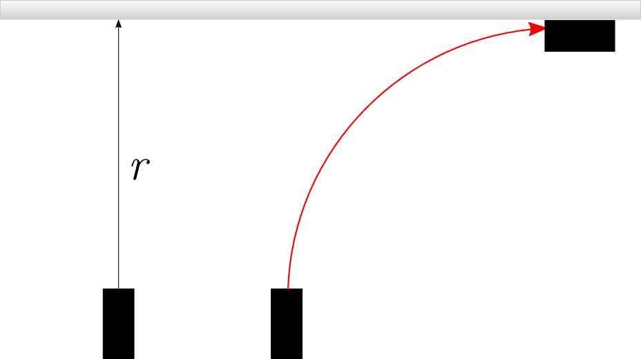

A car driver going at some speed ##v## suddenly finds a wide wall at a distance ##r##. Should he apply brakes or turn the car in a circle of radius ##r## to avoid hitting the wall?
Kinematic equations : (1) ##v_x^2=v_{0x}^2+2a_{0x} (x-x_0)## and (2) ##x=x_0+v_{0x}t+\frac{1}{2}a_{0x}t^2##. Newton's 2nd Law : ##\Sigma \vec F = m \vec a##. Kinetic frictional force supporting circular motion on a road of radius ##r##: ##f_k = \mu_k mg = \frac{mv^2}{r}##
1. For the car to apply brakes, we have ##v^2=2ar⇒a=\frac{v^2}{2r}=μg\;\;[ma=μmg]⇒v=\sqrt{2μgr} ##
2. For the car to go in a circle ##\frac{mv^2}{r}=μmg\Rightarrow v=\sqrt{\mu gr}##.
We find from above that the maximum velocity ##v## possible to avoid a collision is ##\sqrt{2}## times as much if the car applied brakes than if it moved in a circle.
Which means that the car can afford to move with ##\sqrt{2}## times the speed if it applied brakes than if it moved in a circle in order to avoid collision.
Hence it would be better for it to apply brakes than take a circular turn. (My answer)
Am I correct?
Looks good apart from braking and turning use static friction, not kinetic. Kinetic friction applies only when you skid.

Thank you, hadn't realized that. Always took friction to be kinetic when relative motion was there.
I can understand the use of static friction when you take a turn. The turn is what brings it on.
However, when you brake, don't your tyres go from rolling to skidding mode? Isn't it kinetic friction when you brake?

No. Take a look at a car braking next time you get a chance. There's no skidding. Skidding makes a noise, burns and damages the rubber on your tyres and leaves rubber on the road. Braking reduces the speed at which the wheels turn and static friction causes the vehicle to slow without skidding.
That's the purpose of an anti-locking braking system. If you brake too hard, then the wheels can lock and skid. An ABS prevents that.
