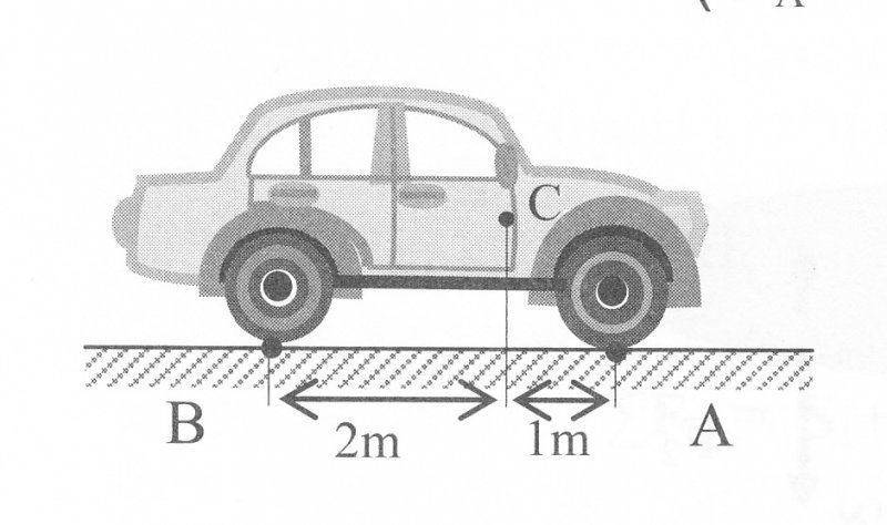

A car of weight 17[kN] starts to move. the coefficient of friction is 0.6. the dimensions in the drawing.
The height of the CoM, point C, is 0.5[m]. the front wheels drive the car.
What are the pressing forces on the front and rear wheels and what is the friction force on the front wheels.
Friction: f=μN
Moments: F1L1=F2L2
Rf is the reaction on the front and Rr is on the back. the reactions caused by the weight:
$$R_f=\frac{2}{3}\cdot 17=11.33$$
The friction force on the front: f=0.6⋅11.33=6.8. it should be 4.36.
The friction "pulls the carpet" under the CoM and creates a moment which is balanced by the rear wheels:
$$0.5\cdot 6.8=R_r\cdot 2\rightarrow R_r=1.7$$
This force adds to the reaction to the weight: Rr=(17-11.33)+1.7=7.37
Of course it's not true. it should be Rr=4.47. the pressing force on the front wheels should be Rf=7.27

You can solve angular momentum problems by choosing an arbitrary axis. You are not required to choose an axis about which something is actually rotating. You are not required to choose an axis through which an axle passes. This makes the wheel radius irrelevant.
In the usual case, almost any axis will work. You want to choose one that will simplify the problem by eliminating one or more terms from the resulting equations. Good choices are:
An axis positioned at the center of mass.
An axis positioned at the point of application of a key force.

Let NR be the normal force on the rear wheels and let NF be the normal force on the front wheels. Let μNF be the frictional force on the front wheels. With this notation, what is the force balance in the vertical direction and what is the moment balance about the center of mass?
Chet
Chestermiller said:
I respectfully disagree. One can take moments about any axis, even if the center of mass is accelerating, if one includes the moment of the pseudo force -ma. However, in this problem, it is best to take moments about the center of mass.
I agree with your disagreement, but was trying not to include that pseudo-force.
In posts #1 and #16, you omitted the moment about the center of mass caused by the frictional force.
$$\left\{ \begin{array}{l} NF+NR=17 \\ NF(0.5\cdot\mu+1)=2\cdot NR \end{array} \right.$$
$$\rightarrow NF=10.3, \ NR=6.7, \ \mu NF=6.18$$
It should be: NF=7.27, NR=4.47, μNF=4.36
$$\rightarrow NF=10.3 \ NR=6.7 \ \mu NF=6.18$$
I get the same result that you got, and I'm pretty confident in what I did. In the results that they got, the sum of the normal forces don't add up to the weight.
