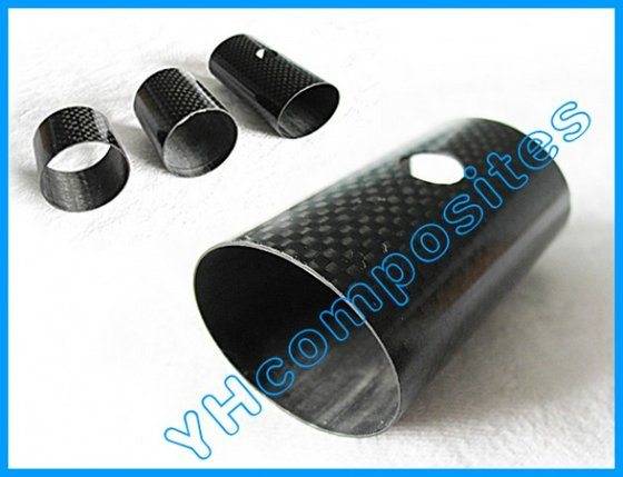

Karl christophersen
Hi all, my question is if i have a length of carbon fibre tube, one is round the other is oval and orientated along its longest side is it more stiff than the round one? Reason for asking is i am trying to make a telescopic carbon fibre pole that is more rigid than the round ones on the market. The object on the top of the pole will keep the orientation of the pole at the correct position.
Thanks in advance
I am a layperson, not an engineer or mathematician.
For a given circumference, compared to a circle, the elliptical cross section will be stronger through its semi-major axis and weaker through its semi-minor axis.
If the primary bending load is in a predictable direction, you can align the semi-major axis that way. (i.e. if your pole can be kept oriented so its semi-majr axis is vertical, to oppose gravity).
If the bending load is not predictable, or is not evenly distributed (i.e. if the pole can be rotated around its aixs), you'll have a problem - a column is only going to be as strong as its weakest cross-section, so it will be more prone to failure than a comparable circular cross-section.

Thanks for your reply Dave
It occurs to me that some experimentation with lengthwise fluting/corrugation might help with stiffness.
I think you'd wouldn't need them all the way around, just at the semi-minor axis, to add stiffness there.
But I've never seen this done, and I'm just spitballing.
A question occurs to me though:
What is the advantage of yours intended to be over a circular cross-section?
A large diameter tube is stiffer than a small diameter tube, so if strength were the only consideration, there'd be no need to change it's shape. You'd just use a wider diameter tube (it wouldn't need to have thicker walls). This is not what you want, of course.
Clearly, the goal then must be to achieve similar strength but with less weight.
And that raises the question: just how much weight do you think you could save your potential customer?
An elliptical cross-section with a 2:1 ratio would use only 71% of the material as that of a round tube (at a cost to strength of [ ?? ]).
Let's assume an ideal case that you find a design where the strength is not compromised i.e. it equivelant to the same diameter circular tube.
Would your 142g pole really outcompete their 200g pole?
(I guess, if weight were a premium, such as ultra-light craft, sure. But I get the impression that's not your application.)

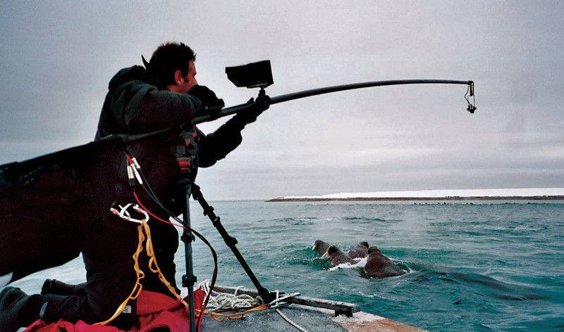

Without giving too much away about potential applications as this picture shows the pole can maintain its position a chosen axis with minimal lateral pressure. Mech engineers technical formula lost me to be honest, if i could only decipher the formula. My goal was to increase rigidity by approximately 25%.

Karl christophersen said:
OK. OK. Hold the phone.

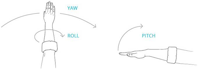

The cross section you posted is an ellipse that is horizontal. That is its weakest orientation with respect to gravity.
BUT -
that's not the point of it, is it?
The horizontal orientation is intended to induce an arch in the rod, which actually provides lateral (roll) stability. (The rod cannot rotate around its long axis as long as it is arched):
That is a completely different kettle of fish than mere rigidity against gravity.
Apologies to @Nidum . S/he was correct is saying we don't have nearly enough information.
Sorry the ellipse illustration was merely showing the shape i thought would be good, not the orientation. I thought if i could make a pole with the longer side about 20% more than the shorter side i would be able to increase it's strength along its long side whilst minimising loss of rigidity on the shorter side. Here is the use of the pole i had in mind, as you can see the majority of the force is one direction.
These poles get used up to seven stories high and after about 3 stories a lot of pressure is lost through the flex in the pole, there is very minimal sideways pressure.

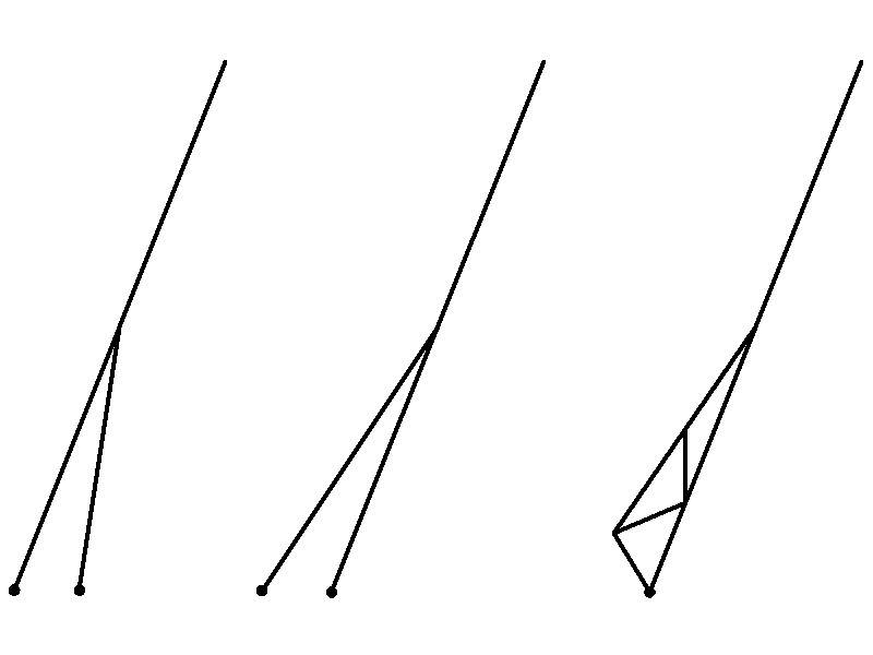

An answer to that problem could be to have secondary support to reduce the flexing .
Can't make specific recommendation without knowing how this system is mounted and controlled at the bottom but conceptually it could be arrangements like this :

Yes part of the problem is the lever length .
With shorter extension lengths the operator could compensate for any flexing by applying more load at the bottom of the rod .
As the extension length gets greater applying more load at the bottom of the rod to compensate for flexing becomes progressively more difficult and less effective .
Solution to problem for long extension lengths requires more stiffness in the rod and a more effective way for user to apply load at the bottom .
These problems together can be solved by the use of a lightweight support structure for the rod and by devising a more effective hand hold .
