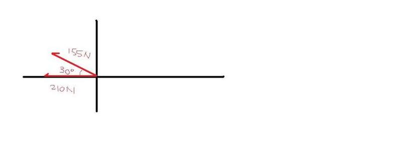

Andrew and David kick a football at the same time. Andrew kicks it with a force 155N and David kicks it with a force 210N. Angle between the two forces is 30 degrees. Calculate the magnitude and direction of the resultant force.
Cosine law
Magnitude = Sqrt (1552 + 2102 - 2(155)(210)cos30 )
= 108.38N
Direction: Use sine law
I don't understand why the answer at the back of the book used cos 150.
If I were to draw the diagram, would the 2 vectors appear in quadrant 2?
Are they assuming that one of the vectors is parallel to the x axis? (like this):
I was assuming that the vectors were at an angle to the x axis...
It doesn't matter what direction they punt in. Look at this picture:
You have figured out r. In the triangle with angle a you know all three sides. If you want to use the law of sines, what angle do you know besides the unknown a? That might answer your question.
