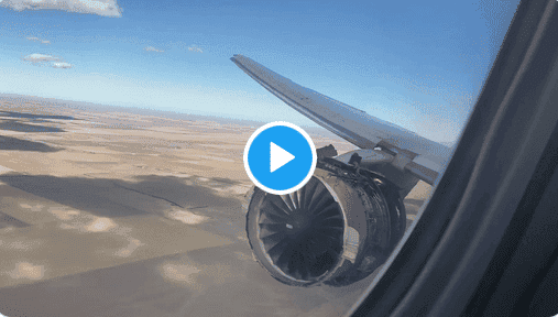

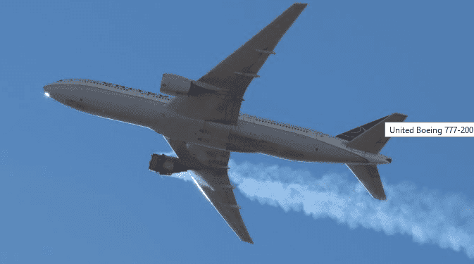

Astronuc said:
Yeah, not what you want to see when looking out of the cabin window...
Photo taken through an aircraft cabin window of a jet engine nacelle and wing, with a play button overlaid, over a flat desert landscape under a blue sky.
Photo of a United Boeing 777-200 in flight against a blue sky, seen from below, with a white fuel dump or vapour trail streaming from behind the right wing; a white label reads United Boeing 777-200.
Losing an engine in flight is not so bad. All airliners can fly fine with one engine out.
The most scary thing is that the debris can penetrate the fuselage and kill passengers. That really happened a few years ago. But if you are alive enough to look out the window and see that scene, you already survived the most dangerous part.
The second most scary thought is that the cause of the engine failure may not be random. It could be an error that could also cause the other engine to fail the same way.
The third level thought (maybe most scary) is that the engine failure damaged the wing and the wing is about to fall off.
My best wager is that most passengers would not think about such things. They would be thinking about turning on their cell phones to phone home.

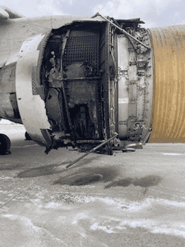

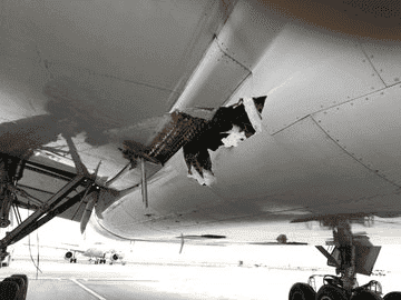

Some pictures:
Close-up photo of a large jet engine fan with curved metal blades, viewed from the front on a wet ground with a puddle of water and a yellow-striped edge on the nacelle.
Photo of a damaged jet engine nacelle on an aircraft, with the cowling torn open and blackened interior components exposed, lying on a wet tarmac.
Underside of a large jet aircraft's wing and engine nacelle showing a ragged, torn-open hole in the cowling with exposed interior structure, with landing gear visible at left and right.
That'll buff right out.
  • Wow
