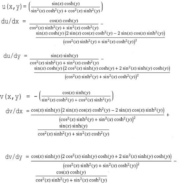

Oopss.. Ok here it goes.. Very nasty.
Ouch. Ok, I asked for that. Very nasty indeed. You are going to have use trig and hyperbolic trig identies to show CR holds. But we know it does. Do you really HAVE to it that way? Are you working with computer algebra system or did you do this by hand? If you doing this with software then you could at least check that if you put in x=1 and y=2 for example that CR holds. I don't think anyone will actually check a mess like that. I know I don't feel like doing it. Sorry.
BTW, if you really do have to do it that way, you might think about my suggestion to try and simplify the denominator before you start differntiating using identities. You could write it as cosh(y)^2-cos(x)^2 or sinh(y)^2+sin(x)^2, I think. That might help a little, but geez.

Also, the expressions for du/dx and dv/dy already have one term in common. So only the remaining term needs to be compared.
Similarly, dv/dx and du/dy have a term in common, although if C-R is to be satisfied, there should be a negative sign on one of them. Perhaps a differentiation error?
