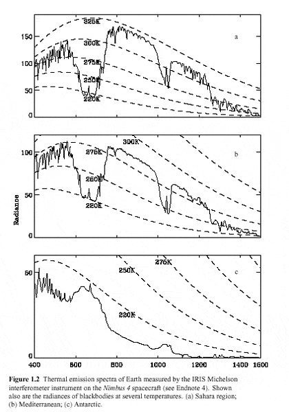

Here is an aspect of reality that is not tracked properly:
The Antarctic emission spectra shows an increased heat emission due to green house gases. That does not fit to the results of simple experiments as suggested above because they do not include the influence of the temperature gradient in the atmosphere. Without a temperature gradient there would be no green house effect. Global warming works with a negative temperature gradient only. I'm not aware of simple experiment which demonstrate this effect correctly.
