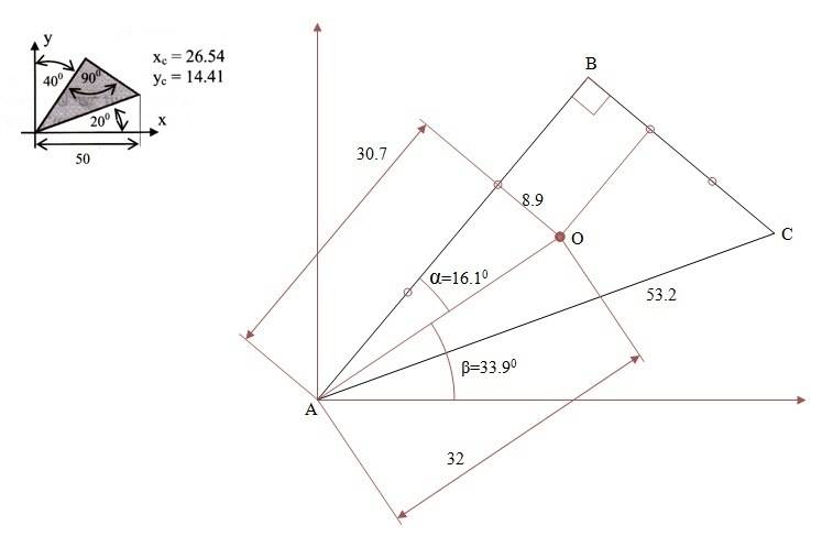

Where's the COM
The COM of a right triangle is a third of an edge apart of the right angle vertex
Edge AC: ##\frac{50}{\cos 20^0}=53.2##
Two thirds of edge AB: ##\frac{53.2\cdot 30^0\cdot 2}{3}=30.7##
One third of edge BC: ##\frac{53.2\cdot \sin 30^0}{3}=8.9##
Edge AO: ##\sqrt {8.9^2+30.7^2}=32##
$$\cos \alpha=\frac{30.7}{32}\rightarrow \alpha=16.1^0$$
$$\beta=(30^0-\alpha)+20^0=33.9^0$$
Now i refer to drawing B:
$$x_{COM}=26.5 \surd,\ y_{COM}=17.8 \otimes$$

Are you trying to say that the value for xCOM is correct but yCOM is wrong?
yCOM is suppose to be = 14.4?
Now why aren't you taking the intersection of the medians to determine the point O which is the COM?
Karol said:
Where's the COM
Your result is correct, but it would be easier to use the formula in the link, after having determined the coordinates of the vertexes.
http://www.mathopenref.com/coordcentroid.html
