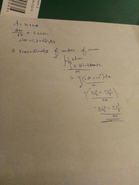

The mass of non uniform rod increases linearly with distance from lighter end. If m is mass of the rod and l it's total length a the linear density at lighter end, then found the distance of centre of mass from lighter end
I put λ= kx+a where lands is linear density k a constant and x the distance from lighter end and integrated but can't get the answer in terms of m l and a
Please show us what you did.
So how do I eliminate k from the equation

Remember that m = ∫(kx+a)dx

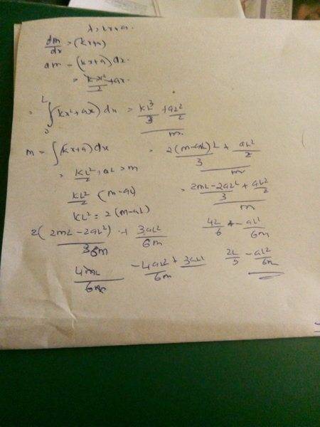

I think I made a mistake in my first calculation , is this one right?
Yes this looks right.
