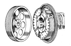

Dale said:
And no, I don’t know how a centrifugal clutch works.
A centrifugal clutch is found for instance on go-karts or small motorcycles. You have a rotating assembly that is attached to the motor, often directly to the motor shaft. It spins with the shaft. This assembly contains a pair of weights which are spring-loaded so that, at rest, both are together hugging the motor shaft.
Around this assembly is a steel drum which is attached to the drive mechanism. Often a chain ring is bolted on and a drive chain runs from here to the rear wheel.
When the motor is idling, the rotation rate of the clutch assembly is insufficient to drive the weights apart. The force of the spring is sufficient to keep them together. When the motor is revved up, the rotation rate increases, the weights move apart and contact the drum. The drum spins and the kart or bike takes off.
https://en.wikipedia.org/wiki/Centrifugal_clutch
It is a convenient design since it engages and disengages automatically with no risk of stalling the engine.
As has been noted, when viewed from the inertial frame the weights move in a near-circular path. There is some degree of outward spiral as the clutch engages, but the acceleration of both weights is always centripetal.

and how you will explain someone what push weights outward every time when engine increase RPM?
In an inertial frame the weights are never pushed outwards. Their acceleration is inwards at all times.
if weights accelarte inward,like you said than spring will compressed
every time when you increase enigne RPM,weights moves outward
You are again confusing “moving” with “accelerating”. The clutch moves outward, but at all times the acceleration is inwards. There is never any outward push because there is never any outward acceleration.

Let’s work this out mathematically in the inertial frame. To simplify things we will assume that there is enough dissipative effects so that the spring is always at its dynamic equilibrium length. Let ##k## be the stiffness of the spring, ##m## be the mass of the clutch, ##r_0## be the unstretched length of the spring, ##r## be the radial position (the length of the spring), ##\alpha## be the angular acceleration, ##\omega## be the angular velocity, and ##\theta## be the angular position. The unit vector in the outward pointing radial direction is ##\hat r = (\cos(\theta),\sin(\theta))##.
Setting the centripetal force equal to the spring tension we get ##m r \omega^2 = k (r-r_0)## which immediately gives us ##r=\frac{k r_0}{k-m\omega^2}##. For a constant angular acceleration starting from rest we have ##\omega = \alpha t## and ##\theta=\frac{\alpha}{2}t^2## which gives a position $$x=\frac{k r_0}{k-m t^2 \alpha^2}(\cos(t^2\alpha/2),\sin(t^2\alpha/2))$$ then ##v=\dot x## and ##a=\dot v## and finally we obtain $$v \cdot \hat r = \frac{2 k m r_0 t \alpha^2}{(k-mt^2\alpha^2)^2}$$ There is also a closed form expression for ##a \cdot \hat r## but it is too annoying to write.
Setting ##r_0## to 2 cm, ##k## to 100 N/m, ##m## to 1 kg and ##\alpha## to 1 radian/s^2 we can plot the equations graphically. Here is a parametric plot of the position from t=0 s to t=9 s:
Here is a plot of the outward component of the velocity ##v \cdot \hat r##
And here is a plot of the outward component of the acceleration ##a \cdot \hat r##
Note that the outward velocity is always positive and the outward acceleration is always negative. In other words at all times it is moving outwards and at all times it is accelerating inwards. Since it never accelerates outwards there is no force that pushes it outwards. The idea that it must be accelerating outwards simply because it is moving outwards is not correct in an inertial frame.
