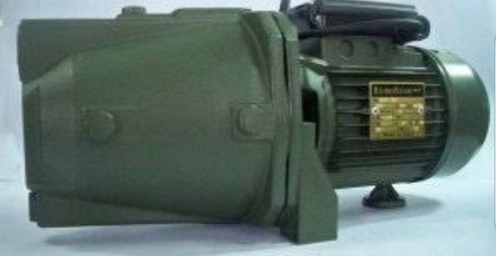

I read about it, actually trying over 30 mins. Such as
https://www.irrigationtutorials.com/selecting-a-pump-using-pump-curves/

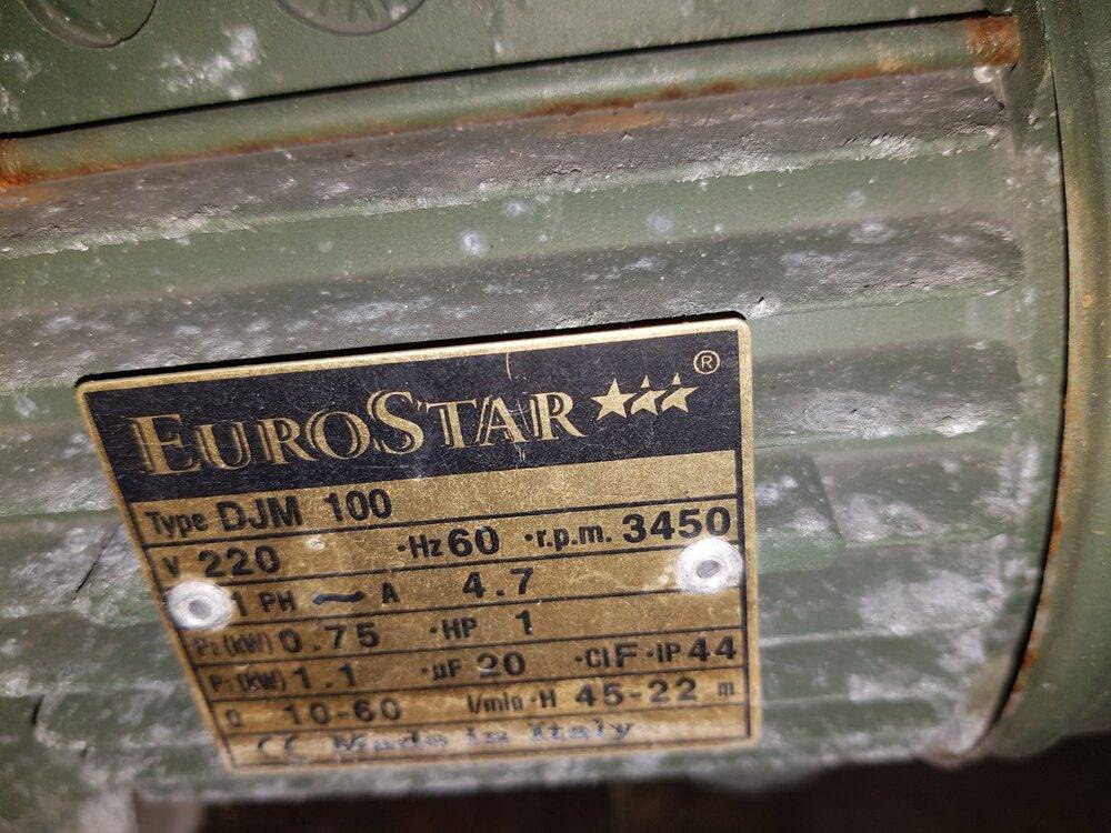

But my pump has no pump curve data. It has this label on the unit though
Close-up photo of a green motor nameplate reading EuroStar, Type DJM 100, V 220, Hz 60, r.p.m. 3450, 1 PH, A 4.7, P2 (kW) 0.75, HP 1, P1 (kW) 1.1, µF 20, CL F, IP 44, Q 10-60, H 45-22 m, Made in Italy.
There is a Vmin . H 45 -22 m
Its 22 to 45 meters? Numbers seem to be reversed in Italy.
I just want to know what equivalent pressure you would get while bathing with the pump directly on and no water tank.
Hmm. If the pressure is 100 psi. Wont the shower jets hurt your skin?
I'm not familiar with that notation, but it looks more like liters per minute and head in meters. 22 meters is 30 psi and that is probably the dead head pressure..

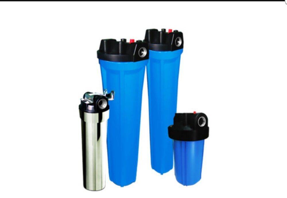

I plan to put sediments filter before the pump.
Four water filter housings on a white background: three blue plastic cylinders with black caps of differing heights, and one polished stainless steel cylinder with a chrome head.
So the water flow before pump would be slower. What would occur to the pump or impeller when the source is not instant source of water? Can it cause cavitation corrosion too?
There will be no problems for a short while when priming.
When you change or clean the filter you will get air in the system. That will move through the pipes until it can escape. After changing the filter you might vent the air from a valve before the pump. The air will be pushed out by mains water pressure.

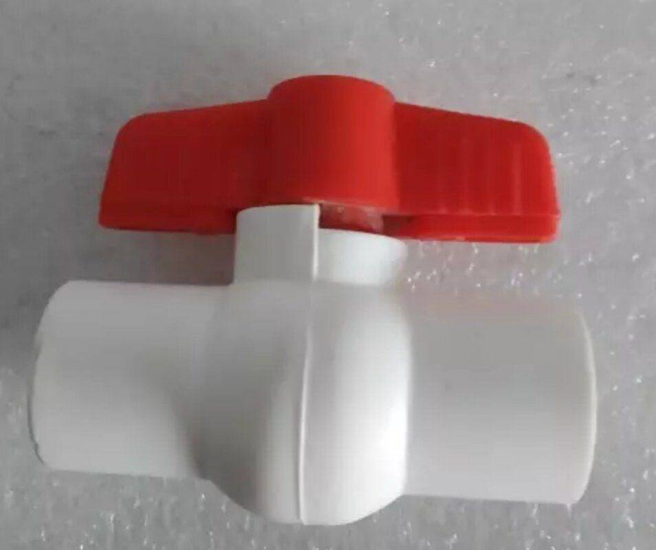

Two red-handled gate valves side by side: a white PPR plastic valve on top with a smaller bore, and a brass valve below with a wider threaded bore.
I notice a ppr 3/4" gate valve has narrower inside compared to a 3/4" bronze gate valve which has wider inside. I guess the pressure inside the bronze gate is stronger? I wonder why would they make the ppr gate valve smaller inside.

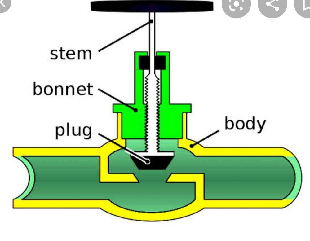

Lnewqban said:
Yeah. So white is a glove valve.
Cross-sectional diagram of a globe valve with labelled parts: stem, bonnet, plug and body, with the plug seated inside the flow passage of the pipe.

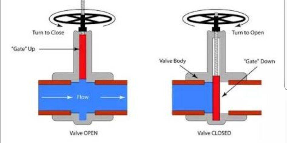

Bronze is a gate valve.
Cross-section diagram of a gate valve shown open and closed: a red gate rises out of the flow path when open and drops across it when closed, with a handwheel on top.
So it is categorical glove valve has higher pressure loss? How many percent loss compared to gate valve? Why would people use glove valve given same 3/4" pipe size?
"Unlike the gate valve, globe valve can be used for regulating flow or pressures as well as complete shutoff of flow. It may also be used sometime as a pressure relief valve or as a check [FONT=Roboto]valve[FONT=Roboto]. Compared with a gate [B][SIZE=14px][FONT=Roboto]valve[/B][SIZE=14px][FONT=Roboto] or ball [B][SIZE=14px][FONT=Roboto]valve[/B][SIZE=14px][FONT=Roboto], the globe [B][SIZE=14px][FONT=Roboto]valve has[/B][SIZE=14px][FONT=Roboto] considerably [B][SIZE=14px][FONT=Roboto]higher pressure loss[/B][SIZE=14px][FONT=Roboto] in the fully open position."

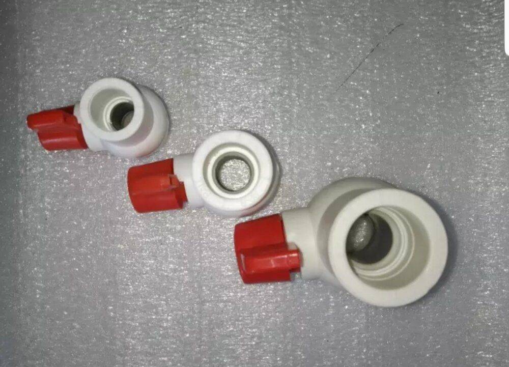

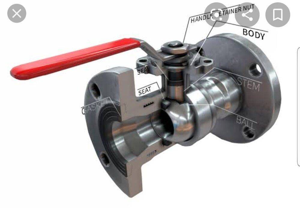

What do you think about ball valve? I found out a ppr has ball valve. My plumber said its easier to work with ppr than pvc pipe that needs solvent to connect it. Btw is there any bad chemical from pvc pipes?
Cutaway diagram of a flanged ball valve with a red lever handle, labeled parts including handle, retainer nut, body, seat, stem, ball and gasket.
Also if the water is rusty. It can make the ball valve harder to work? Raw mechanical engineering inquiry.
The reason there are so many types of valves, materials and ways to connect them to the pipes is the huge diversity of residential, commercial and industrial applications that exist.
All depends on the application you need the valve for.
Please, see:
https://en.m.wikipedia.org/wiki/Ball_valve
All you need to know about plastic materials for pipes:
https://en.m.wikipedia.org/wiki/Plastic_pipework
There is no bad chemical from PVC pipe, except when it burns.
That pipe is not the best for hot water, CPVC is better.

Has anyone used a ppr ball valve as main gate valve in a house? Its the only way for me to use ppr in the house. I can't use the globe valve as there is pressure drop, and it is difficult to use solvent in connecting pvc pipes. But here is the weird thing, my plumber age 60 years old hadent encountered or used ppr ball valve before. This is the last thing i want to know so i can decide everything and let it all be done with. Thanks so much for all the theoretical assistances.
Small white plastic ball valve with a red lever handle, shown on a grey textured surface, with socket ends on both sides of the body.
Three white plastic pipe fittings with red plastic lever handles, shown as small ball valves, lying on a grey textured surface.
