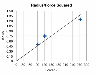

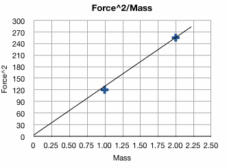

Write a proportionality statement for F, m, f and r using your three proportionality statements.

We did a lab in class and those were the proportionality statements I came up with.
They might be wrong, we used very poor equipment and the data is nopt very good, nor is there much to work from.
Here are the two graphs that I based my last two proportionality statements off of:
See what I mean about the bad data? I was pretty sure about the mass graph, though...
I guess I should have clarified that the rest of the variables were constant for the proportionality statements.
Thanks again.

How does radius relate to Force though, Is my graph correct?
I cannot see your graphs...they are pending approval.
Sorry, didn't look at that.
Is r~F or r~F^2? (if everything else is constant)
if by "everything else" you mean f and m, then r ~ F

Edit: I changed the graphs and the lines were just as poor, so I don't know why I decided to square them in the first place, thanks for pointing that out.
