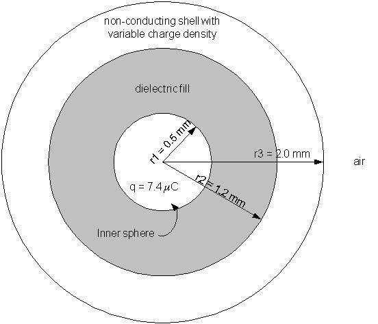

The question is:
A spherical capacitor contains a solid spherical conductor of radius 0.5mm with a charge of 7.4 micro coulombs, surrounded by a dielectric material with er = 1.8 out to a radius of 1.2mm, then an outer spherical non-conducting shell, with variable charge per unit volume p = 5r, with outer radius 2.0 mm. Determine the electric field everywhere. (Remember that in a linear dielectric material you can work out the equations as though they are in a vacuum and then replace e0 by e0er.)I know that the electric field for a dielectric is e = Q all over 4 pi k epsilon zero r^2. I also know that the electric field for the innerest conductor can be found using E = 1 over 4 pi epsilon zero time Q over r^2. Using this equation I got 3.25 x 10 ^ -9. However I do not know how to solve the outer most shell given with the charge per volume value. And for my dielectric electric field formula how do I get the er value of 1.8 that was given in the problem into the equation?

To get the electric field inside the outer dielectric, calculate the the charge enclosed by a sphere of radius 1.2 mm<R<2 mm. For that, you have to calculate the volume integral ∫ρdV. ρ is the charge density and it is given, ρ=5r. dV is the volume element. It can be replaced by the volume of a thin shell concentric with the innermost sphere, dV=4πr2dr. The volume integral gives the charge inside the outer dielectric, and you have to add the charge on the inner sphere to get all charge enclosed by a sphere of radius R.

In the range 1.2 mm<R<2 mm you have a non-conducting shell with a charge distribution. Hopefully, you can use ε0 here, when using Gauss' Law: At a distance R from the centre, the surface integral of E over a sphere of radius R is equal to the charge enclosed by the sphere:
4πR2E=7.4 *10-6 +4π∫(5r)r2dr, the integral goes from r=0.0012 to r=R.
For r>R, you can consider the total charge (that of the inner sphere + the charge of the non-conducting shell) as a point charge at the centre, and apply Coulomb's law to give the electric field strength as function of R.

Maybe I am not seeing how the sphere lokks correctly (If it is not too much can you plaese draw it). Also, So then how do you calculate for the electric field outside of the shell? Or is the 1.66 times ten to the tenth couloumbs the electric field for r > R. Thanks for all the help much appreciated.
