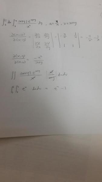

these are on the picture
transformation, jacobian
I don't know how to enter the equation, so i uploaded the picture..
is it alright?
I think I solved it somehow, but not quite sure if it is right...
please tell me if there's a wrong process.
thank you..

The link to the image reports back with "401 Access Denied."
Looks right except for the limits of the integrals at the very last line that seem wrong.
