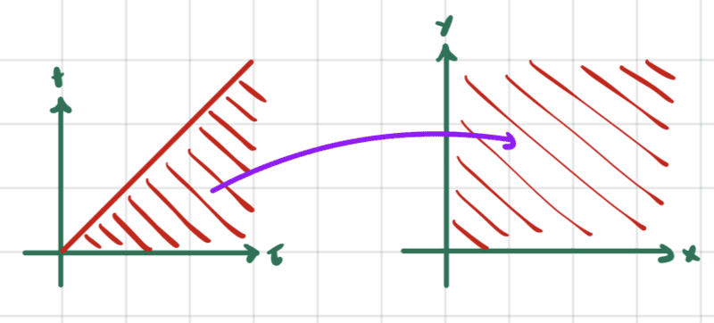

My question is: how do I find the limits of integration in (6)? What is a good strategy for reasoning about such a task?
The region of integration of (5) is the first quadrant in the ##xy##-plane.
My first thought is that since ##y=\tau## then ##\tau## goes from ##0## to ##\infty##.
However, this doesn't work for ##x##.
For a given ##t##, since ##x>0## then ##\tau## goes from ##0## to ##t##.
It seems that the mapping is
$$\int_0^\infty\int_0^t g(\tau)f(t-\tau)e^{-st}d\tau dt$$
The integration region for x and y is ##x > 0## and ##y > 0##. Replace by the expressions with ##t## and ##\tau## and you get
t-\tau > 0, \quad \tau > 0.
Move ##\tau## to the rhs of the first: ##t > \tau##. The integration region is therefore ##t > \tau > 0##.
