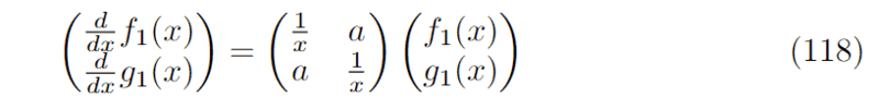

Suppose the solutions ##f_{1}(x)## and ##f_{2}(x)## of the following system of differential equations is known:
Now the system I wish to solve is:
Upon first glance, it seems that the association ##f_{2}(-x) \leftrightarrow f_{1}(x)## and ##g_{2}(-x) \leftrightarrow g_{1}(x)## will do the trick and we would be done.

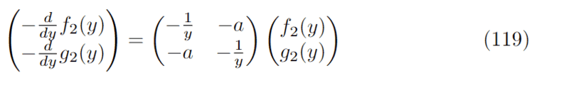

However, I tried making the change of variables ##y=-x## in equation (117) and got the following:
which is now the same form as equation (118).
Suddenly, it seems like the solution is now ##f_{2}(y) = f_{2}(-x) \leftrightarrow f_{1}(x)## and ##g_{2}(y) = g_{2}(-x) \leftrightarrow g_{1}(x)##
and I am left with a contradiction. Could someone point out to me where the mistake is? I feel like it is something simple that I am not seeing.

Sorry there was a typo here, the second sentence above should have said "Suppose the solutions ##f_{1}(x)## and ##g_{1}(x)## off the following system of differential equations is known..."

I don't quite understand. So the situation was, if I knew the solutions ##f_{1}(x)## and ##g_{1}(x)## to the system in equation (118) and now I have a separate system equation (117) that I wish to find the solutions to. Then I can notice that because (118) and (117) have the same forms, the solution to equation (117) is just ##f_{2}(-x) = f_{1}(x)## and ##g_{2}(-x) = -g_{1}(x)##, that is, I can write the solution to (117) in terms of solutions to (118). But once I made a change of variables to change equation (117) to (119) and I try to write the solution to equation (119) in terms of the solution to equation (118), I end up with a different set of solutions.

Right, I thought there might be a mistake in my chain rule somewhere for (119), but if I write everything in terms of ##y=-x##, is it not ##\frac{d}{dx}f(-x) = \frac{dy}{dx}\frac{d}{dy}f(y) = -\frac{d}{dy}f(y)##, which is what I had in (119) already?
Yes.
Yes. It's the same system of equations.

Sorry, I believe ##f_{2}(-x) = f_{1}(x)## and ##g_{2}(-x) = -g_{1}(x)## should be the correct solution.
That being said, if I were to work with the ##y## variables system, since they are the same form as (118), I could take the solution to (118), which we already know and swap out the ##x## variable for ##y## right, since these are just dummy variables anyway. Then in the final step could I not plug back my original transformation ##y=-x##?
That's not right. Let's take an example that we can explicitly solve:
$$\frac d{dx} f_1(x) = af_1(x)$$Has a solution ##f_1(x) = e^{ax}##.
Now, take:
$$\frac d{dx} f_2(-x) = -af_2(-x)$$This also has the same solution ##f_2(x) = e^{ax}##
We can check this:
$$\frac d{dx} f_2(-x) = \frac d{dx}e^{-ax} = -ae^{-ax} = -af_2(-x)$$We can also see that your proposed solution: ##f_2(-x) = f_1(x) = e^{ax}## is not correct:
$$\frac d{dx} f_2(-x) = \frac d{dx}e^{ax} = ae^{ax} = af_2(-x)$$
PS I suspect the root of your problem may be that you don't understand the concept of a dummy variable and you are unable to express an equation for ##f_2(x)##. Instead, you are fixed on ##-x## as your dummy variable for ##f_2##. For example. If we have:
$$f(-x) = -2x + 1$$then we can immediately write down:
$$f(x) = 2x + 1$$
