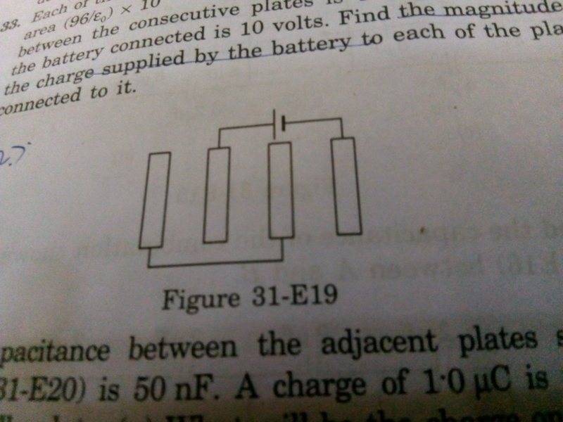

Each plate in the figure has area a and separation d , end of battery is e find charge supplied by battery
. each facing plate will have half the charge supplied by battery, but I am confused how the potential is applied[/B]

You have 3 capacitors in series. Draw a schematic diagram, simplify if possible, then solve as a circuit problem.
Is potential difference across the series connection equal to the emf of the battery?

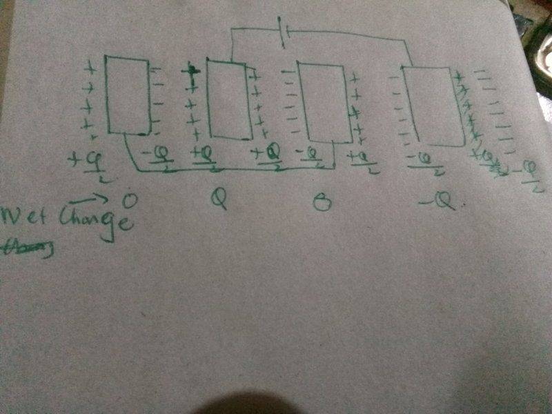

Okay, I thought this is how charge gets distributed, please correct me if I am wrong
Your first tipoff that something is wrong is as follows: put a test charge inside the leftmost plate (4). The E field in that plate (E4) is of course zero. Now look at the contributions to E4 from all 8 sides of charge.
From side 8 (left side of leftmost plate) you get some E field, if non-zero, pointing, say, to the left (- charges on side 8). Now, sides 7 thru 2 cancel out any contribution to E4 since those are pairs of equal and opposite charge. That leaves side 1 to contribute to E4. But surface charge density on side 1 must be equal to that of side 8 in order to get a zero E4 field, yet you have those sides as being of opposite polarity, so something is wrong.
You'll have to show your work for further help. You do have equal and opposite charges on all inside adjoining surfaces, and you have Q2+Q4=0, and Q1+Q2+Q3+Q4=0, so that 's good. But somewhere you made a slipup (assuming I'm right to begin with :biggrin:).
At last I know what you mean by "q/2 to each facing plate". You meant q/2 to each face of one plate (and -q/2 to each face of the other plate). A pity you did not try to explain that before.
I suggest you start by ignoring the other two plates and consider how charge would be distributed across the faces of the two connected to the battery. Would you still put magnitude |q/2| on each face? Then insert the other two plates and consider how charge would rearrange itself on those. Of course, that might lead to rearrangement of charge on the first two, but it should give you a better understanding of how things should look.

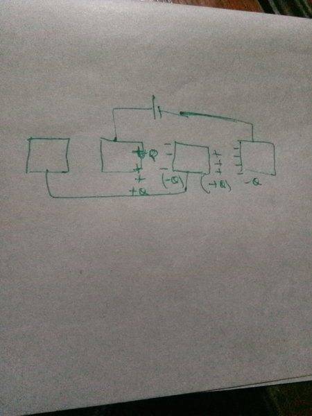

I got electric field inside each plate to be zero, but not sure about charge distribution
This is incomplete and hard to read.
Show your work.
BTW if you haven't covered capacitance yet you can derive all 8 charge densities by the two equations in Q1-Q4 I posted in #12, plus σ = D plus V = - d⋅E.
