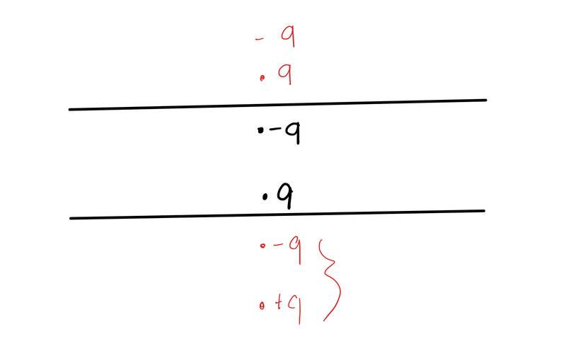

Find the force on p.c. q placed inside a parallel plate capacitor in
vacuum, with grounded plates, separated at distance h. The point charges are at
distance h/4 from the closest plate
F=qe

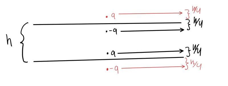

Before I can find the force on q I must balance the charges. This problem starts of with -q and q inside the capacitor. I have added image charges on the opposite side of each plate. Would this work?
Diagram of two parallel conducting plates separated by distance h, with charge q and -q placed between them, plus red image charges -q and q located outside each plate with arrows pointing to them.
quittingthecult said:
Homework Statement:: Find the force on p.c. q placed inside a parallel plate capacitor in
Relevant Equations:: F=qe
Why is each plate only reacting to the nearest charge?

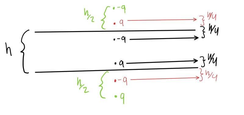

I just want to give a heads up that this is my first real problem that isn't as trivial as a p.c. and a single grounded plane so this is really new to me.
I guess I didnt think about the image charges also effecting the plates.
Hand-drawn diagram of two horizontal parallel conducting plates separated by distance h, with image charges of -q and q placed at distance w/4 from each plate, with additional green image charges at h/2 spacing, red arrows marking distances w/4.
When I consider the effect an image charge has on the opposing plate I came up with the new image charges in green. Although this seems like it would go on forever until eventually the pc are too far away to really have a true effect on the positive q in the capacitor.

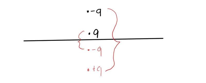

No, you misunderstood my comment. Just consider one plate but both charges to start with. What do you get for that?
I believe I should get this as a result

I think your green distance is incorrect..
And that the framers of the problem were kind to you ?
Right.
Bear in mind what the point of the method is. In the above diagram, you can throw away the plate, replacing it with the image charges. This will not change anything in the region above where the plate was; all the fields, forces and potentials will be the same. Things will change below the plate line, but we don't care about that.
Now introduce the upper plate. What do you get?

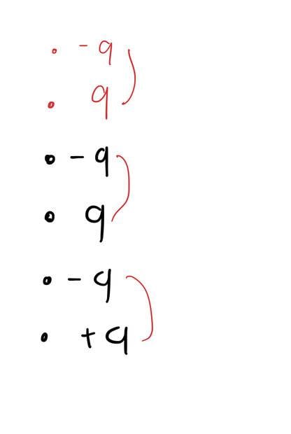

Should it be this? Kind of like what I originally drew?

For the green distance, how would I think about it? I am thinking the green charges negate the red charges, so it would make sense they would be h/4 away

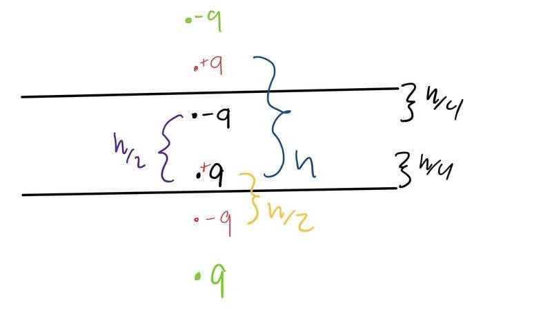

The green distance is 3h/4 unless I misunderstand. Why h/2.?? Put in the distances on the image in #8 so we understand each other. The distances don't depend upon charge (for a plane mirror image) Then take look like @haruspex recommends
Actually there was no reason. for me to label the h/2. I am trying to find the force wrt to the +q inside the capacitor. So I just need to know how far is each charge so I can plug in the right r when I take the sum of all forces.
So the bottom green q should be a distance h and the top green q a distance 3h/2? All adjacent charges should be a distance h/2 away from each other right?

No. The lower plate should no longer be there since it is replaced by the two image charges. That leaves you with one plate and four charges. So what do you need to add to replace the upper plate?

Right the plate shouldn't be there anymore I missed that. Its like you said, we are throwing away the plate and replacing it with image charges.
So to replace the upper plate, I should have this?

No, you are still missing it. After replacing the lower plate with two image charges you have four charges in total. So how many images in the upper plate?

So I would need 4 image charges to get rid of the upper plate?
Yes, I believe so.. though suddenly I am worried by the resulting asymmetry.

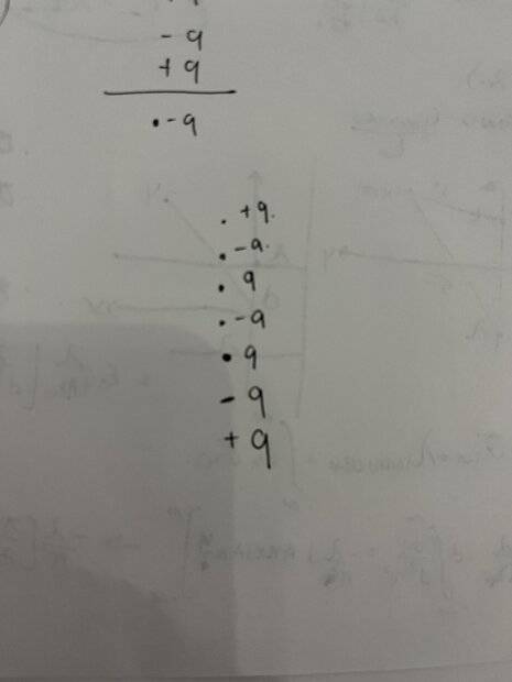

So like this? I am considering the +q already in the capacitor a charge belong to the upper as well. Or would I need an additional negative charge all the way up top?
Handwritten method-of-images diagram: a column of charges labelled -q, +q, -q, then a line and a result of -q at the top, beside a second column of +q, -q, q, -q, q, -q, +q running downward.
Ah! Jst seen my error. I have not allowed for the redistribution of charges on the first plate when the second is introduced. Let me think some more...
Edit: @quittingthecult, looks like you do get an infinite sequence of charge images. As in your post #17, but keep going symmetrically above and below.
You should find that the repulsion of like charges cancels in pairs, leaving only the infinite sequence of unlike charge attractions to sum.

Could you show me how that would look? My professor nor my textbook have gone over infiniite sequences
Fill in the gap sizes in post #17. you should see the pattern.
For me the easier way to do this is to do one charge at a time. Draw the ladder of images for just the positive charge. Then shift the ladder by d/2 and subtract (for the negative) Of course you can also write this down algebraically
