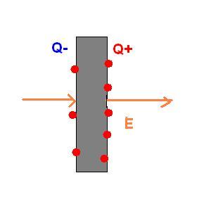

This is no homework question, i am only trying to clear my concepts.
Lets say i have a conducting rod placed vertically. I give it a charge Q. The charge would stay on the outer surface. The charge will distribute equally over the surface. What would happen if i place the charged rod in an electric field of magnitude E?
(see attachment)
I think the negative charge will get concentrated on the left side of rod and the positive charge on the right side. But is it possible to find the amount of charge which will shift to the left and right faces or rather, the final charges on both the faces?
Any help is appreciated! :smile:

There is no 'net negative' charge. The only excess charge is the +Q you put on the conductor. Now this conductor will always have a zero field inside it. So in presence of an electric field, the charges in the conductor(including the charge that it naturally possesses) will be rearranged in whatever way, so that net field inside remains zero.
I'm not sure how you can calculate the final charges on both faces, as charges of the native conductor also participate in the distribution.

I think it would be interesting to solve the simpler problem first: A plate of large area A and small thickness d, with Q excess charge, put into a homogeneous electric field E, perpendicular to the plate. What is the surface charge density on both sides of the plate?
ehild

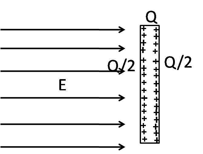

Since we have kept it in a uniform field E, an equivalent but opposite in direction, a field gets induced in the plate. As ILS said, the field inside inside is equal to ΔQ/Aεo, therefore ΔQ=AEεo. I am not sure how this charge will appear on the surface, i mean i know the charge will go to outer surface but how will this affect the outer surface charge distribution, what will be the final charge on outer surface and what's the use of the small thickness "d" that ehild has provided?

That d is small means only that the extension of the plate can be considered very big - infinite- with respect to thickness. Otherwise you need to consider the "edge effects". The value of the thickness does not influence the result if it is very small with respect to the lateral sizes.
When the plate is placed in the electric field, the field appears inside the plate at the first instant. The electric field inside moves the free electrons of the conductor till they reach the surface. Also free electrons will flow from the opposite surface towards the inside of the conductor to make the inside neutral. We say that the applied electric field induces excess surface charge; positive on one side of the plate and negative on the other side. The resultant surface charges cause such an electric field that is opposite to the applied field and cancels it inside the plate.
You need to find the amount of surface charge which appears on both sides of the plate when an electric field E is applied.
When the conductor has a net charge Q, it will change the outer field. Find out the resultant field on both sides of the plate.
ehild
Assume the electric field outside also enters the conductor. This would have a field E to the right(inside the conductor), going by your diagram. Now the conductor plate needs a field E to the left, to counterbalance the external field, and hence redistributes charge. Taking a charge Q1 for one side of the plate, equate the field sum to E. :smile:
The initial charge on both the surfaces were Q/2, when we place the plate in electric field, the final charge will be Q/2-AEεo and Q/2+AEεo, am i right?
Close! :)
What is your resulting ΔQ between the charge on the left and the charge on the right?

2AEεo?
It is correct. :smile:

Ah, thanks ehild! But i am still confused on which surface, Q/2-AEεo or Q/2+AEεo will reside? Any clarification on that will help. :smile:
The charge will reside on both surfaces of the plate. If the applied electric field points to the right, Q/2+AEε0 charge is on the right-hand side surface of the plate and Q/2-AEεo is on the left-hand side.
