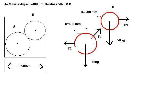

Ok as you seen I been trying to get familiar with a few different type of exercises, this is a FBD type exercise.
I attached the picture showing the exercise done, I just want you to check if you notice any errors, thanks you.
Cylinder A- Mass 75kg and Diameter-400 mm, then Cylinder B- Mass 50kg and Diameter 200mm
In FBD you draw the powers that bodies experience. You wrote apart from their weights the forces exerted by the bodies. Also think that the body B has a net force different than zero but it can't move..
Thanks for the reply, but
What do you mean by that?, I really thought I did it right?
you sure is not right?

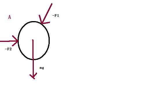

The force F1 is extracted by the body A on the body B. So it should be shown on B's FBD.
The force F2 is extracted by the body A on the wall. So it should be shown on Wall's FBD
The forces -F1 and -F2 in my scetch are those that should be in your A's FBD.
The point of FBDs is to make easier calculate the accelerations on the different axes of the bodies in our system. We can't calculate their acceleration if we don't draw the forces they experience from other bodies.

I forgot to add the reaction force from the ground.. Sorry
Thanks for the help, you went beyond the call of duty with that one, appreciate it.
so you're saying the Force from the right and the force from the B cylinders were missing?
everything else is all good?
Wait with what you said there and even posted a pic, I can assume that the Cylinder B
also needs a Force from the right like this <------ and not like I have it which is like ------->
correct? or I am I looking too deep into it??

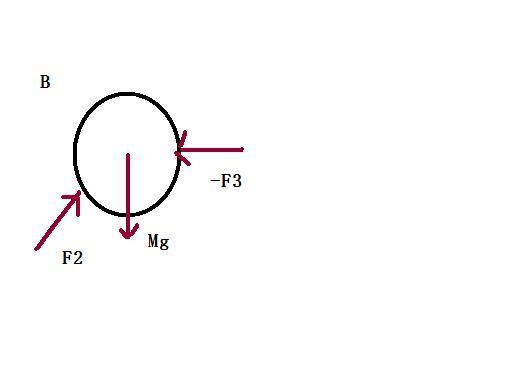

Look:
1) yes the Cylinder B needs a force from the right.
2) to understand the whole thing better, think why you drew your forces like that. Think why you drew F3 pointing to the right.
3) When you give it a though you ll understand that F3 is the Force that Cylinder B exerts on the Wall.. What you need is the Force that the wall exerts on the Cylinder. Think about it... Think about the Forces that act ON each of the cylinders and try to make sense of it..

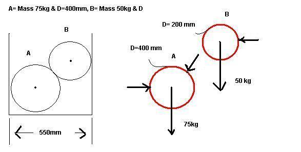

1- Well thanks to your drawing I figured that's what I missed there
2- I drew them like I did because I am going by the reaction of the Cylider, you're showing me that it needs to be the other areas reaction with the Cylinder
3. Yeah part 2 pretty much explains that I didn't follow the correct process
Here is the edited picture, with your advise taken into account, I am not sure if I am missing any other reactions,
You did say something about missing the reaction form the ground?, perhaps my edited still pic is still wrong but check out and provide further guidance please.

Look.. Thats how the FBDs should look like. Think about it and if you don't understand something tell me. The forces shown in FBDs are the forces that have the potential to accelerate the body

Thanks for clearing that up, I do have a question,
Can you explain how in Cylinder A got reaction up and down in the same route?
I never seen that in class, then again we never did this type of exercise in class just
beams.

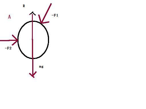

The force that points down is not a reaction. Its the weight of the cylinder ( the force that Earth exerts on the cylinder ). Also its clear that the cylinder does not move downwards so there is a force that act upwards. That force is the 3rd Newton's pair of the net force on the y -axis (but finding the force is another story).
