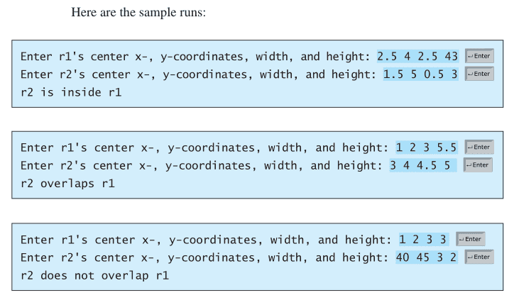

Hi
I have uploaded the problem in the two files 3 and 4. Basically I have to see if the two rectangles overlap each other given the x, y coordinates of the centre and the width and the height of them.
Here is my code in Java.

I have run this with some test cases given and it works fine. I also ran some additional test runs for other cases. So do you think its ok ?
Thanks

The algorithms I have seen for tasks like this do not assume the rectangles to be oriented with 2 sides parallel to the x-axis and 2 sides parallel to the y-axis. By 'test all cases' is this by any chance what the problem writer means?
In the figures in the attached image, the rectangles are oriented with sides parallel to the axes. I don't know if that is something that should be assumed to always be true, though.
isaacNewton,
I altered your code a bit by removing a lot of TAB characters. By having so much indentation, many lines were not completely visible. Now, most of the lines can be seen without having to scroll to the right. Using TABs to indent is not good if it makes the lines too long. I don't know if that's something you can control in your IDE. With some IDE's you can have a TAB get turned into 3 or so spaces.
Jim, I think problem assumes that all the rectangles involved have edges parallel to x and y axis. Mark thanks for the input...
I don't like your magic 1e-8 everywhere. Anytime you have to copy and paste like that you should be thinking about automation. Perhaps write a function, or overload the operator, I'm not familar with Java.
I see you printing individual results for X1 inside X2 and a lot of other cases, not just overlap. Is that a requirement of the question you have not told us? If all you need is a simple yes or no, then there is a very simple and well known algorithm for overlap where the rectangles are parallel with the axes. It's not that hard to derive and you could do it only four comparisons.
Hello gmar, I have posted the questions in an attachment. So yes, there is requirement of printing individual results for one inside the other.
